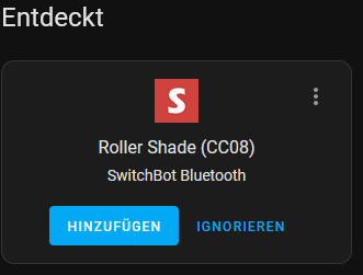

Thanks for the answer. I tried to do what you described, but it makes no difference.
I can se the deviceMac address in Bluetooth integration, so assume that the device is available for the switchbot Bluetooth integration as well.
I have posted a picture of the message I’m getting right away, when I am opening the switchbot bluetooh.
Do you have any ideas?

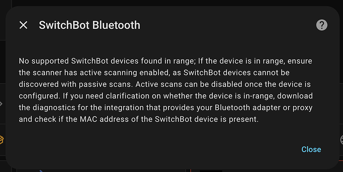

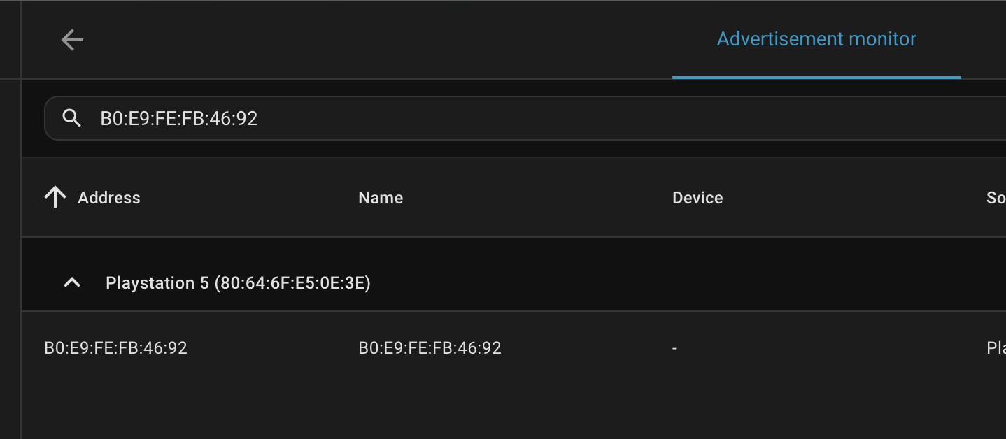

I just installed a shade, it works great on the physical remote or the Switch Bot app.
Unfortunately I can’t get it added to Home Assistant via Bluetooth.
It shows up in the Advertisement Monitor but it doesn’t show up to be added.
If I try to add it manually, this message is shown.
Any ideas?
