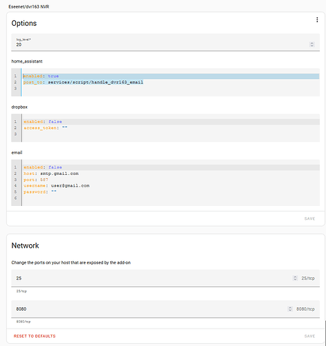

Hi, I have a NVR I want to integrate with HASS on RPI4
I set hass with your plugin
I set the NVR as described
When I click Test nothing happens
Logs shows nothing useful.
[s6-init] making user provided files available at /var/run/s6/etc...exited 0.
[s6-init] ensuring user provided files have correct perms...exited 0.
[fix-attrs.d] applying ownership & permissions fixes...
[fix-attrs.d] done.
[cont-init.d] executing container initialization scripts...
[cont-init.d] done.
[services.d] starting services
[services.d] done.
Starting dovecot
Starting postfix
Starting python server
[2025-04-14 10:29:01 +0200] [270] [INFO] Starting gunicorn 20.0.4
[2025-04-14 10:29:01 +0200] [270] [INFO] Listening at: http://0.0.0.0:8080 (270)
[2025-04-14 10:29:01 +0200] [270] [INFO] Using worker: sync
[2025-04-14 10:29:01 +0200] [272] [INFO] Booting worker with pid: 272
What have I missed?
Where should I find informations regarding camera alarms?
Thanks
I don’t know :frowning: I no longer use or maintain this. I moved everything from an r pi to a laptop about a year ago and haven’t used it since.
but I guess troubleshooting step 1 is verify port 25 is open?
