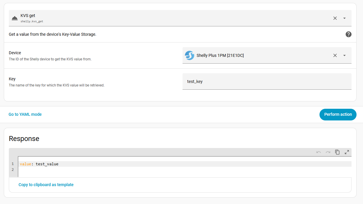

Yes, I’m working on it Add `get_kvs_value` and `set_kvs_value` actions for Shelly RPC devices by bieniu · Pull Request #157349 · home-assistant/core · GitHub
PR has been merged, new KVS-related services will be available in HA 2026.1.0.
