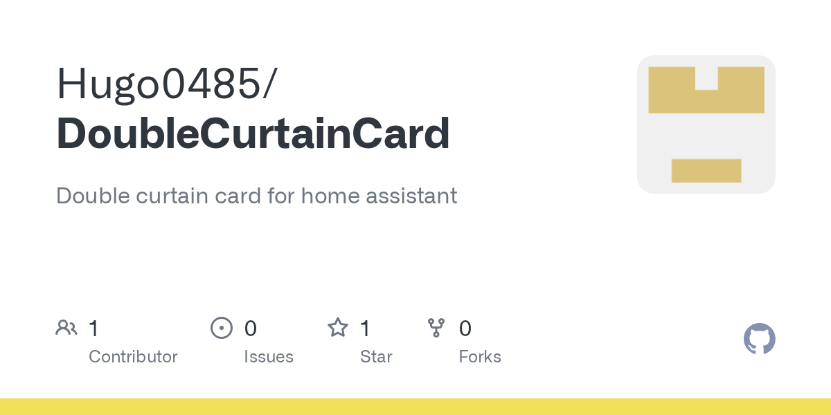

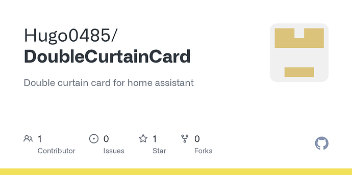

Today i created a card for my curtains(not switchbot) and shared it on my github. just wanted to drop it here in case someone is searching for something like this
