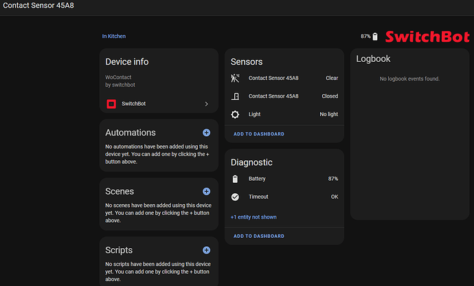

I just got mine too, and it got discovered in HA as “Contact Sensor 45A8”

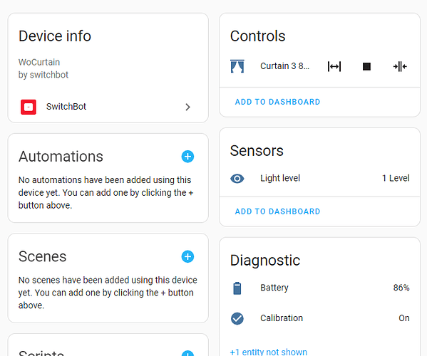

I managed to get it running with just a few changes to the code.
I plan to send a PR in a few days (after I investigate some things and maybe add the quiet mode).
If you want to try it out sooner, you can add git+https://github.com/the-ress/pySwitchbot.git@curtain3 via ‘Custom deps deployment’ addon  and then rename ./config/deps/lib/python3.10 to /config/deps/lib/python3.11 (because the addon hasn’t been updated for python 3.11 yet)

Before you start it, you need to add git+https://github.com/the-ress/pySwitchbot.git@curtain3 to the ‘pypi` field in its configuration.
Then you start it, it’ll install the updated package, and stops again. For me the log looks like this:
After that you’ll need to rename the python3.10 folder, restart HA, and it should work.
(The rename step is there because the addon is built for previous python version so HA won’t find the updated package otherwise. I created a PR for that too: Bump Python version to 3.11 for custom deps by the-ress · Pull Request #135 · home-assistant/addons-development · GitHub)

With these instructions it was straight forward, my curtain 3 is discovered!
