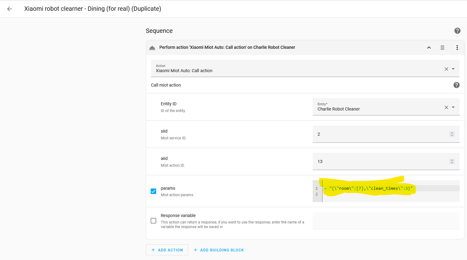

I have now got it working, but I am trying to be more fancy and set additional parameters. When I use the following:
It does run, but it doesnt clean 3 times. Any ideas what Im doing wrong?

Nothing.
The S20+ doesn’t support that, there’s no option to set cleaning per room twice, like S10+ had in the app.
See also: https://www.reddit.com/r/RobotVacuums/comments/1hcy8j1/xiaomi_s20_owners_is_there_a_twice/
No.
Copy & paste the attributes and the actions here.
You must be doing something wrong.
I just bought the S20+ and setup the integration with individual room cleaning per button. Works without issues.
