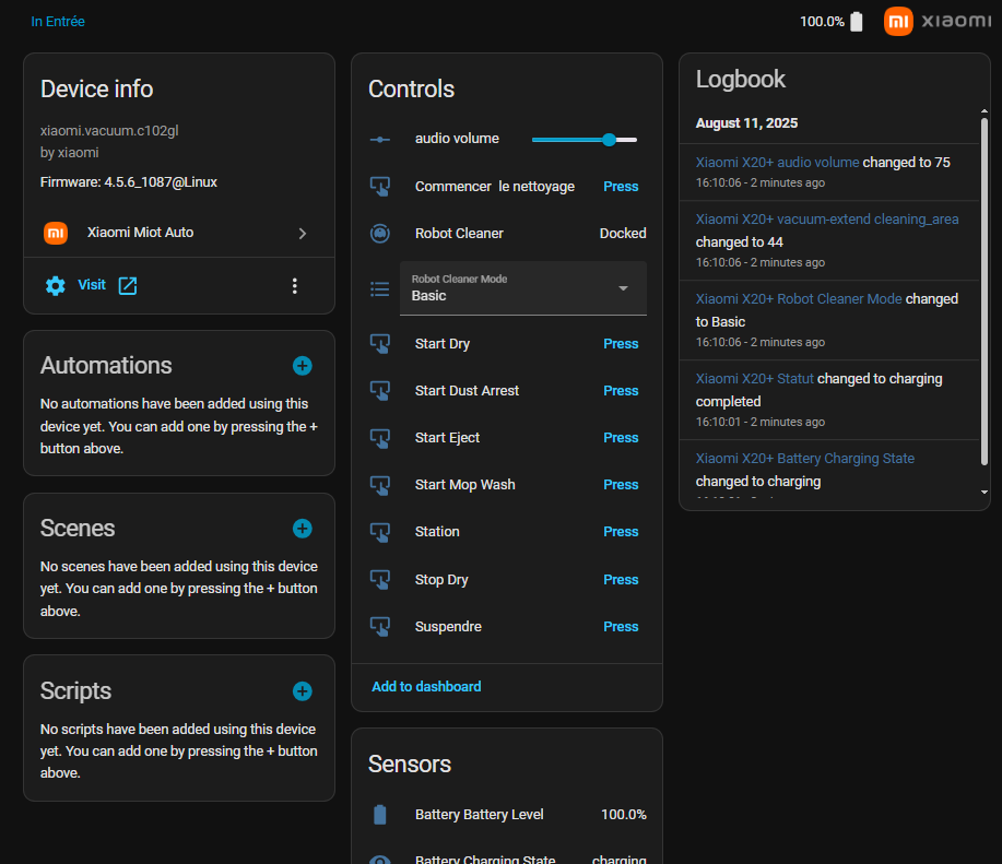

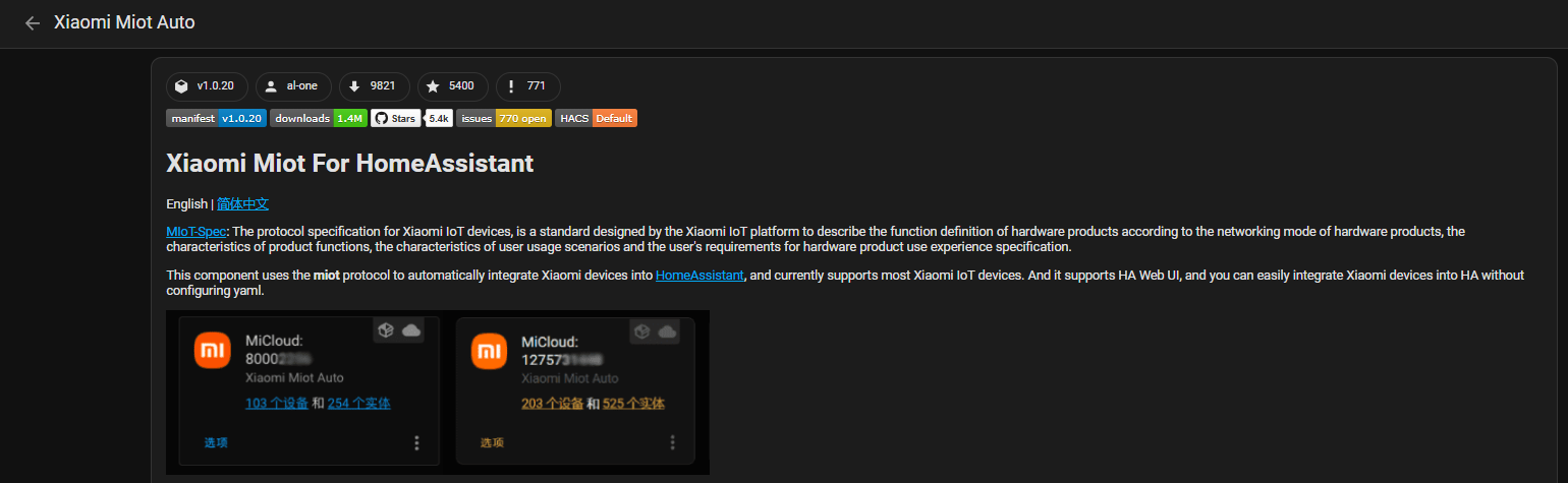

I used Xiaomi Miot Auto from HACS with IP/Token identification (generated with token_extractor.exe) and i works for me
