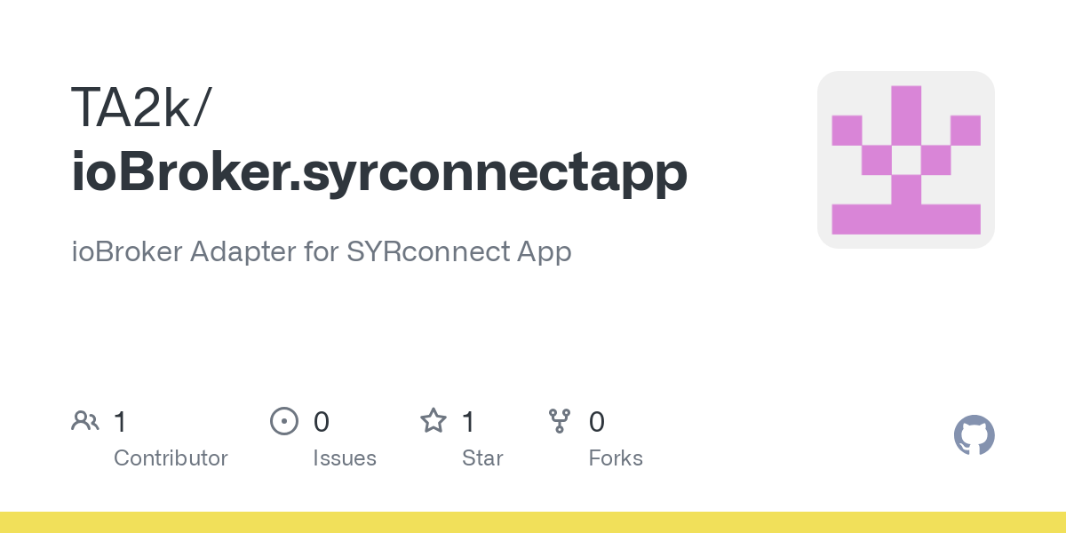

Iobroker has now an adapter to control syr devices via syrconnect app
Maybe someone can port this to home assistant component
