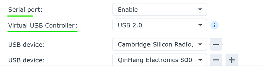

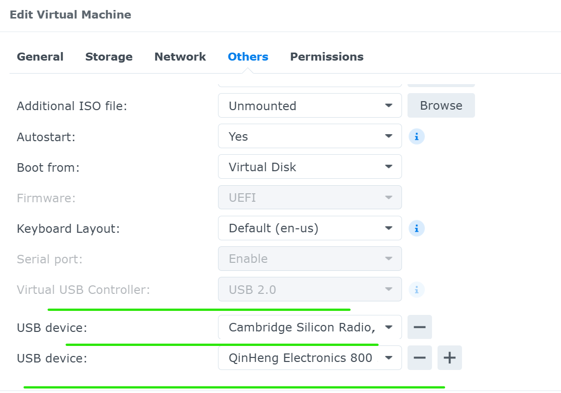

Did you add the USB device to the VM?
I don’t use Synology, but usually there should be a configuration option on the virtual machine to present the device to the vm. If this is not supported a workaround would be to use one of the ethernet based coordinators.
The DSM7 USB bypass works surprisingly well and even recognized multiple devices when I tested adding two dongles.

Thanks, no I hadn’t :grimacing:
Now I have that set I can see the device showing up in the deCONZ config. e.g.

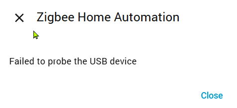

Tried starting the device but get this
Might try restarting the VM.
Some further progress but still not working :thinking:

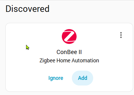

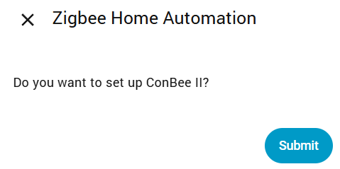

  • After a reboot of the NAS/VM I can see that HA has discovered the ConBee II
Takes a few mins of the spinning circle progress indicator…

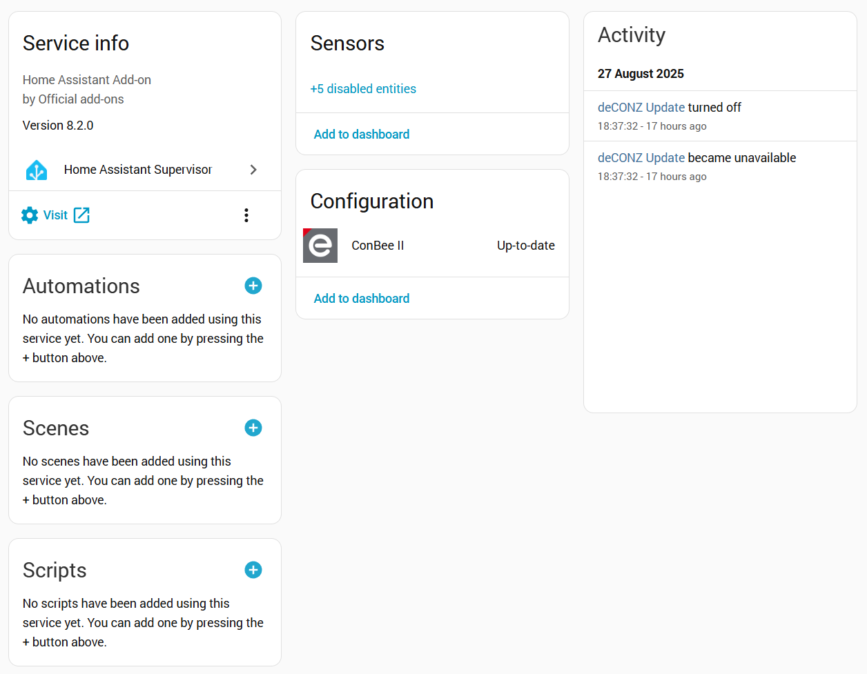

And now the ConBee II has vanished from Discovered section and does not appear in the Configured section of the Integrations page.
It appears in Devices but I don’t appear to be able to discover Zigbee clients from it.
:worried:
I don’t use ConBee or ZHA, but do you need to enable the 5 disabled entities?

Enabled them all :+1:

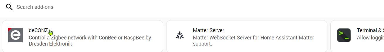

The only Add-on’s I have are:
Should I delete deCONZ add-on (not having much luck with it) and just try ZHA?

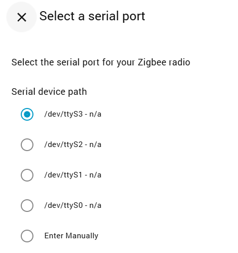

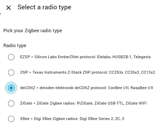

Ok added ZHA, went thru the 10 min setup and got this error:
Failed setup, will retry: [Errno 2] No such file or directory: ‘/dev/serial/by-id/usb-dresden_elektronik_ingenieurtechnik_GmbH_ConBee_II_DE2294200-if00’
So I deleted the the setup and tried to add manually.
But where do I find the path? I no longer appear to have a device called deCONZ, ConBee or even Zigbee

Shutdown the VM and check your Synology settings again to ensure the device is still recognized by the server.
With any changes to USB devices, you need to do a HA reboot, not just a HA restart.

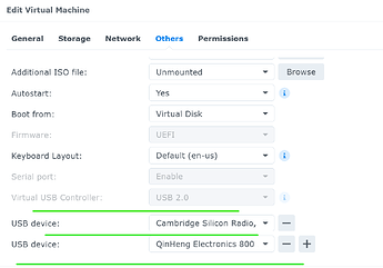

I’d suggest setting the USB controller to 2.0, if you didn’t already.
I am currently running a BT dongle and a Z-Wave dongle in HA from my RS1221+ with no issues.
