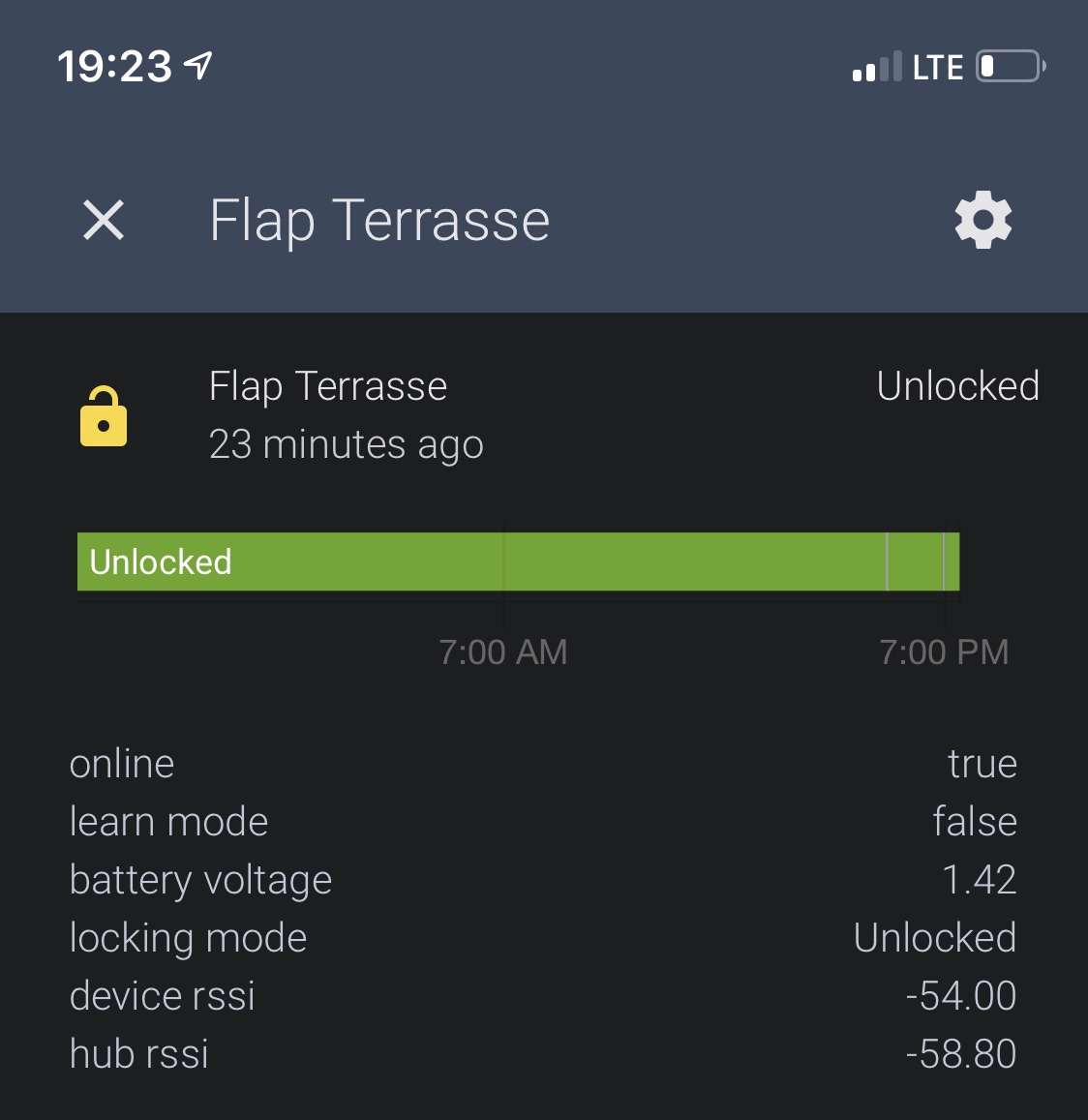

Not quite. If i select “Lock in”, “Lock Out” or " Lock both ways" then this changes the lock state and the lock mode to 1, 2, or 3 (0 for unlocked).
In the app I have the curfew set so that the cats can only come in at night and can only go out when the curfew is over in the morning.
This does not show the flap as locked (or in only) during this period.
I did look at the code and there seems to be a lock mode 4 for curfew but I cannot make it report this condition.
I also note that the app does not seem to report the curfew lock is on in any way.

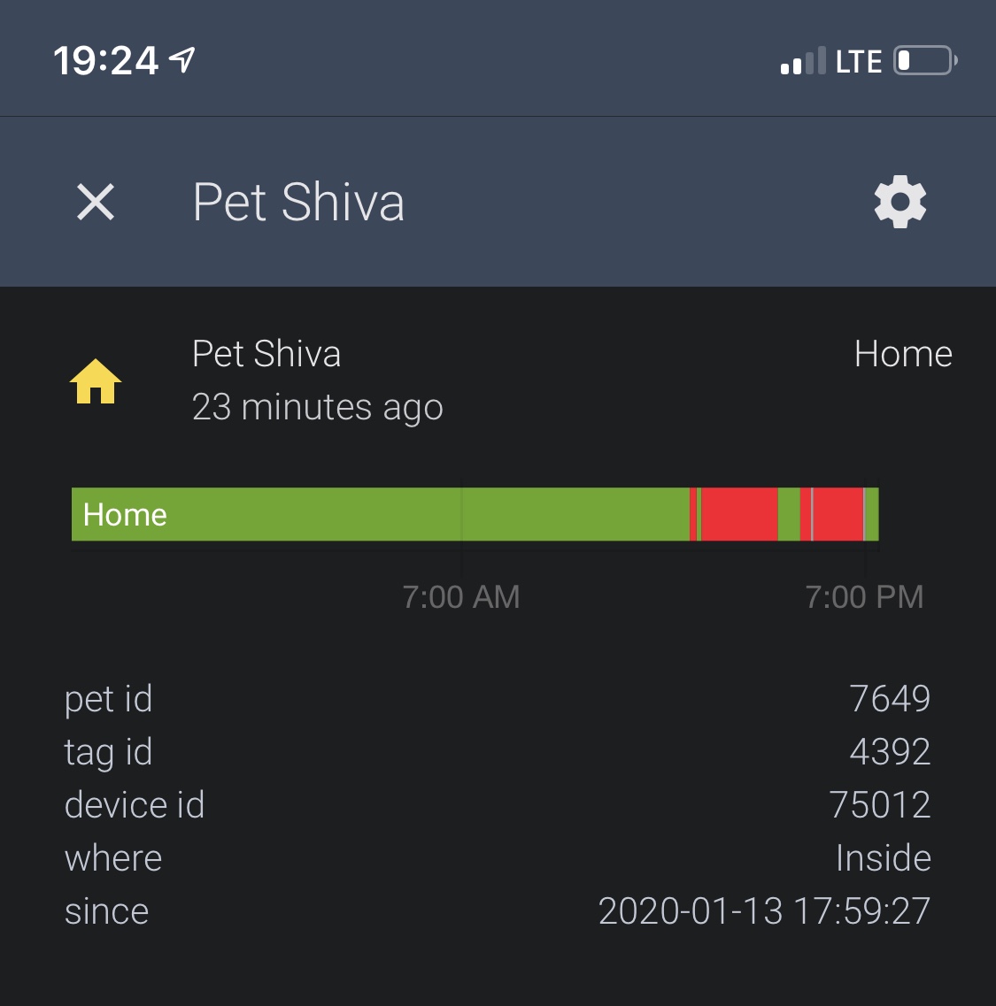

Might be interesting to add an independent state (not linked to petcare) for the pet location (home/away) this would mean if you are only using home assistant for the pet status then it could be be updated by the flap and corrected through HA if wrong.

The icon is your part. Everyone has another pet so I choose a house. Otherwise I would have choosen a cat

Looking at my sensors I assume some change would occur against the attributes of the binary sensor for the cat flap for rssi:
device_rssi: -70
hub_rssi: -72.8
Without taking the hub offline I’m not sure though - if anyone has a reliable way of determining online / offline status it would be good to know so I can add a suitable notification.
