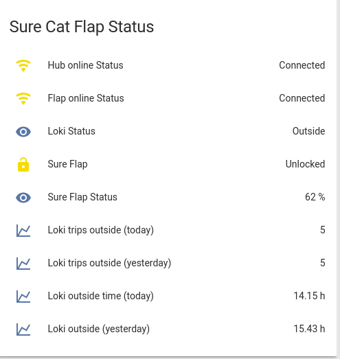

I managed to set up mitmproxy and log into the sure app with this and was able to capture the raw data.
, and the avitar for our pet.
There is nothing to share at the moment and so far i have only experimented a little bit.
Getting any further would require being able to authorize a connection to sureflap, and getting the id’s etc. The app doesn’t use mqtt, but rather http.

I have managed to reverse engineer a lot of their protocol, and managed to get something working.
It polls their servers every couple of minutes. and updates the status.
Though i am unsure of their device id, that their app sends on every update, i used a pseudo random one and it works fine. I will see if i can write it all up and link to some code.

The code works for me at the moment, but can certainly do with other testers. It has been developed for my purposes, and therefor it is in the state it is in.
I have tried to document it a bit in the code and in the readme.
It should work for multiple pets, but it is very untested. It is “read only”, implying that i don’t set any parameters. Installing the python library is probably the hardest.
The home assistant integration is very basic, but it was what i had time for, idealy i guess you would create a hub, and attach any flaps to it and any pets to it. But this works for me at the moment, for me (i might have missed something that is different on somebody else’s app)
Be kind and don’t set the refresh interval too fast as this is polling sure’s rest server.
I am quite busy these days but will try to answer some questions, but won’t be able to guide you through this installation, so you will need some home assistant/developer skills.
