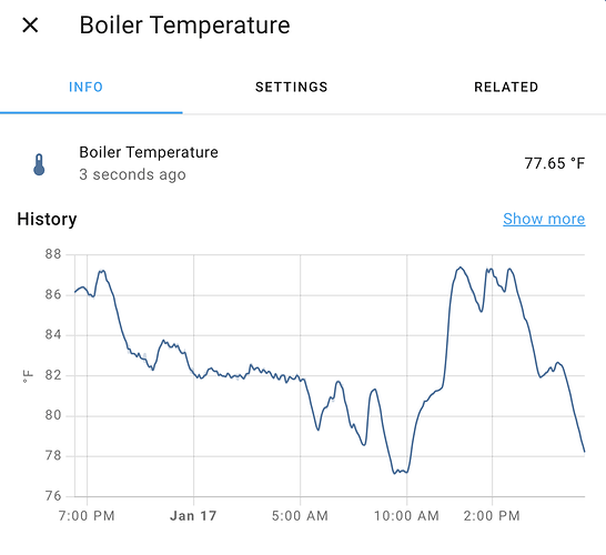

I just dropped a SensorPush sensor on top of my boiler . . . HT.w Water-Resistant Temperature / Humidity Smart Sensor — SensorPush and read it via bluetooth.
@val1 Nice! I have a few similar Govee devices around the house, but all are geared toward air temperature. I’m hoping to get the precise temperature of the exhaust vent through direct contact with the probe sensor and pipe instead of placing an air thermometer directly on top of the vent pipe. Good suggestion, though!

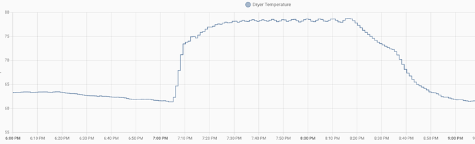

So I just hung one of the SensorPush sensors so it would touch the vent pipe. Got this:
So now I just have to come up with the logic to notify when the dryer is “done”.
