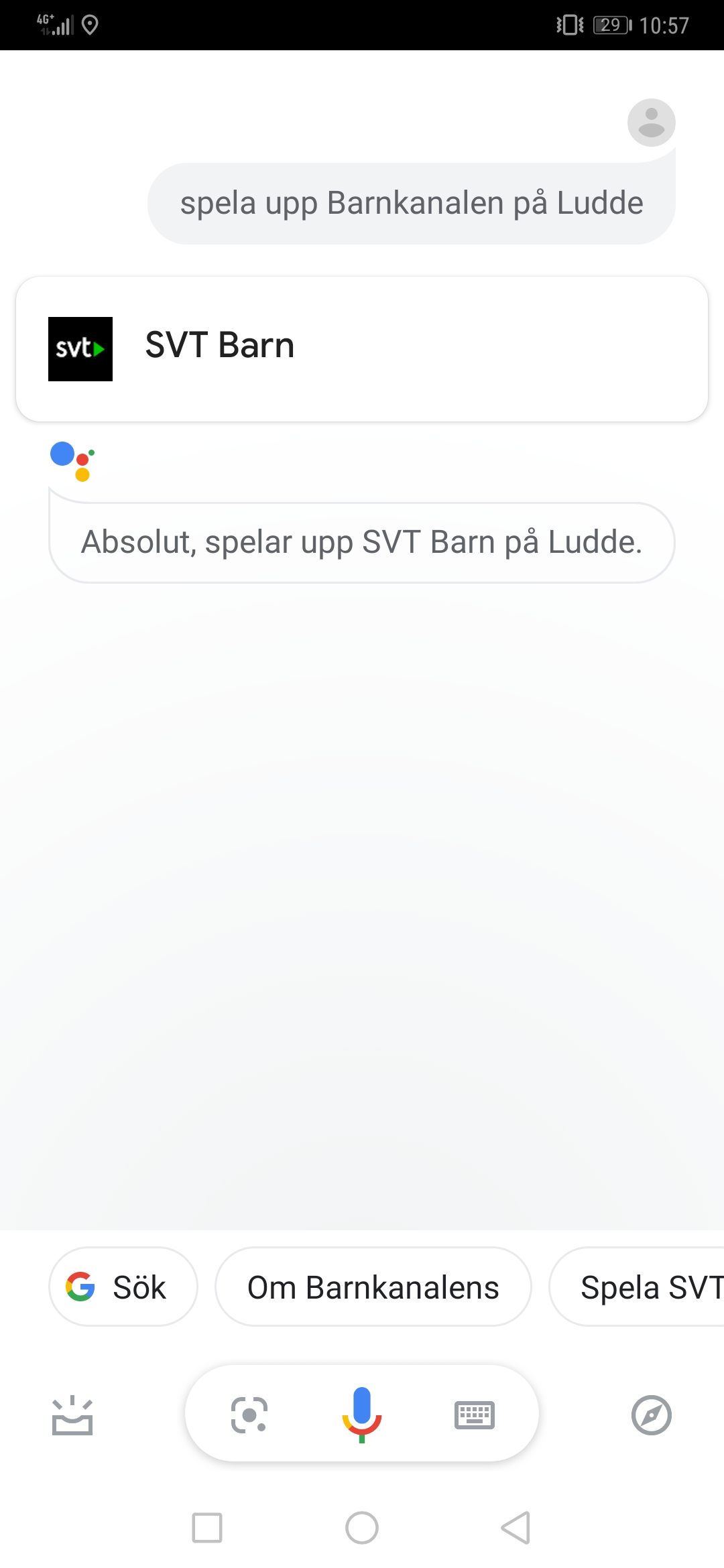

I havenāt paired Google home with hass yet so I can not help you. Tried this tho, seem implemented in Google assistant already. Ludde is my CCast
