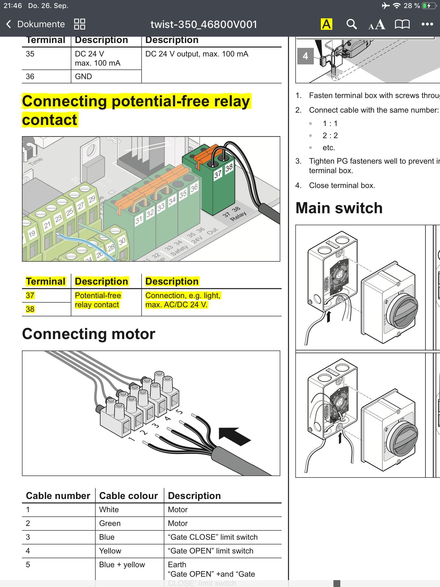

I have 2 wing/swing Gates that I want to Open and close with 2 Gate openers (Sommer Twist 350).
I will install them in the upcoming days.
I have a 2 Channel Switch that is connected to my Home Assistant.
I Need your help for the following:

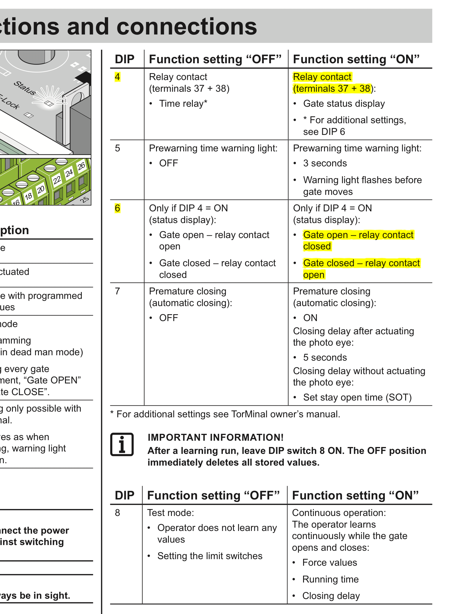

The gate control has a potential free relay that can give me information about the gate status, e.g. Gate open-> relay contact closed and vice versa.
It is possible to connect for example a light up to 24V.
I want to connect Something like a sensor/switch that is connected to Home Assistant and Shows me the information if the gate is open or close.
Thanks for you support
