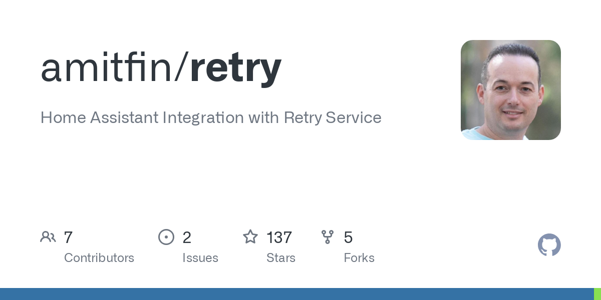

I do that for all control commands. Meaning send command, wait with a timeout for the change to be reflected back and retry up to three times with increasing delays. I did this via autogenerating scripts.
There is a custom component that does this and at some point I’ll discard those scripts and move over. Interestingly the use case they talk about is an irrigation system not turning off.
nice didnt know about this one, thanks will make my life easier :slight_smile:
Thank you, was not aware of this. Will try.
Thank you very much I will test that.
OMG! You learn new things every day!! This is needed, previously I used an automation with a delay!
