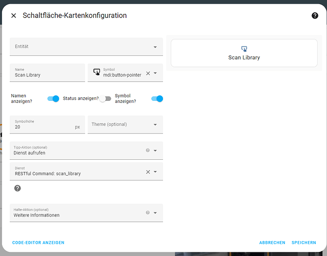

I have built a switch that sends a restful command when pressed (scan a library). This library returns the code 204 if everything is good.
The question now is how could I modify the switch so that this confirmation is somehow visible, e.g. green light on success or red light on failure? The switch would of course have to be reset after a certain time for a new scan.
