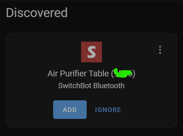

Just updated to 2025.6.1 and the Switchbot Air Purifier Table was discovered. :heart_eyes:

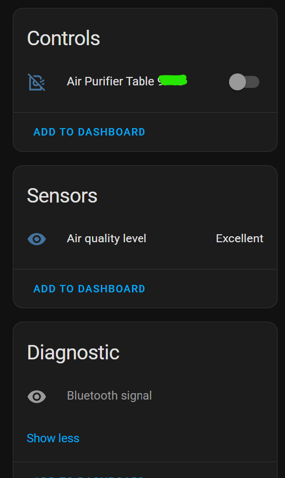

What are the entities that get added with BLE? I have it added from the Cloud integration but I only get on/off functionality and it tells me the air quality. I really was hoping for fan mode and light control.
Sounds like it’s the same entities, aside from ‘Bluetooth signal’ which is disabled by default.

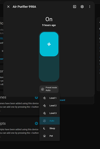

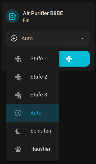

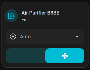

I would say yes! This is what my tile looks like:
You can choose from the preset modes in a dropdown menu as you like.
Much better!

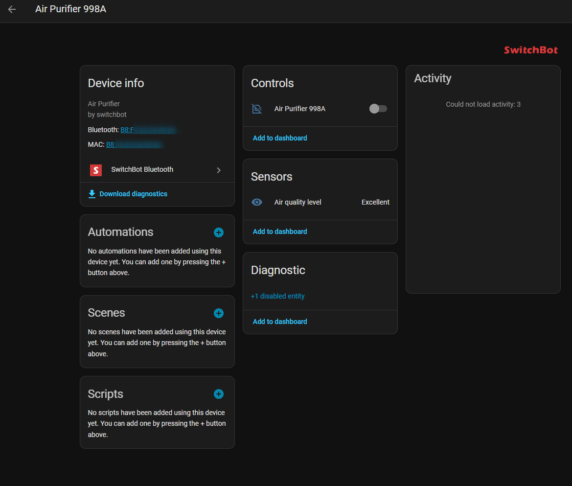

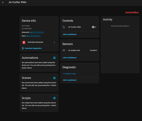

Well, there must be different models then? Or I didn’t set mine up right?

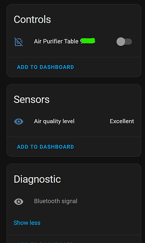

I got my Air Purifier (Amazon.com: SwitchBot Air Purifiers for Home Large Room with Matter Up to 3620 ft², 20dB, Washable Pre-filter, Pet Mode, 10 RGB Colors, Aromatherapy, Work with Apple Home, Google Home, HomeAssistant : Home & Kitchen) yesterday and was excited to set it up. I added it to my Switchbot app, ignored all the Matter stuff it wanted me to setup, and then Home Assistant found it via Bluetooth.
“Great!”, I thought…
But I only have On/Off and Air Quality level. I don’t have speed or mode control.
Very disappointing. The Switchbot app can do everything, Home Assistant via Bluetooth can only turn it on or off.
Firmware version 2.5.
Don’t worry, @Ingo! At first, I thought the same as my Device info page does look pretty much like yours. But…

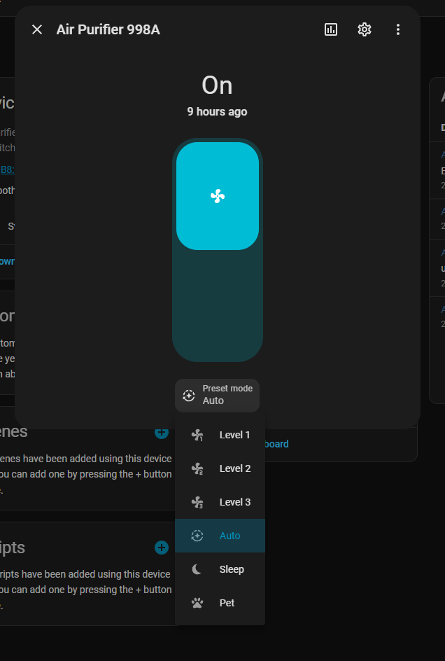

… just try to use this code for a tile:
features:
  - type: fan-preset-modes
    style: dropdown
  - type: toggle
type: tile
entity: fan.air_purifier_b8be
features_position: bottom
vertical: false
Of course adapt fan.air_purifier_b8be to the name ouf your entity. I bet you will get something like this:
Am I right?
Ah! Thanks, I looked a bit harder and realized it has preset mode support! It won’t tell me its current speed, but I CAN control modes. Good enough!
Thanks for making me look deeper!
