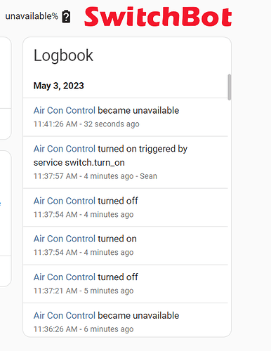

I just got a switchbot bot, I didn’t get the hub as I read it will work with Home Assistant. However I am running into an issue where the bot will become unavailable after only a few minutes. I have scoured the internet and heaps of forums but I haven’t found a solution.
I am using the switchbot integration and it automatically comes up when adding a new device and connects with no issue.
I am able to use the switch with no delay or interference however after only a few minutes it will become unavailable and won’t respond.
I have to reload the Bluetooth integration for it to work but it will only last a few minutes. I use an Intel NUC with the inbuilt Bluetooth.

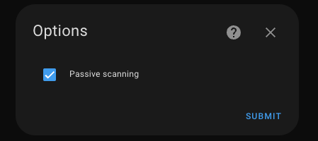

My issue is solved by turnOn passive scanning in Bluetooth Integration settings →

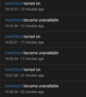

I am having the same issue. I am running the 2023.9.2 in docker on an intel NUC. It was working fine until about 1-2 months ago. I have to reboot the NUC to get the bluetooth back to connect to the Switchbot curtains. I thought at first maybe it was low battery on the switch bot, or firmware on the switch bot. I charged and updated and it did not help. I then thought maybe the host OS needed to be updated, so I updated ubuntu to the latest versions as well. Still it seems after 1 day (2 at the most), my switchbots become unavailable. I have not moved anything or made any other changes other than updating the firmware, the OS and the docker for HA. Anyone else still having this issue
