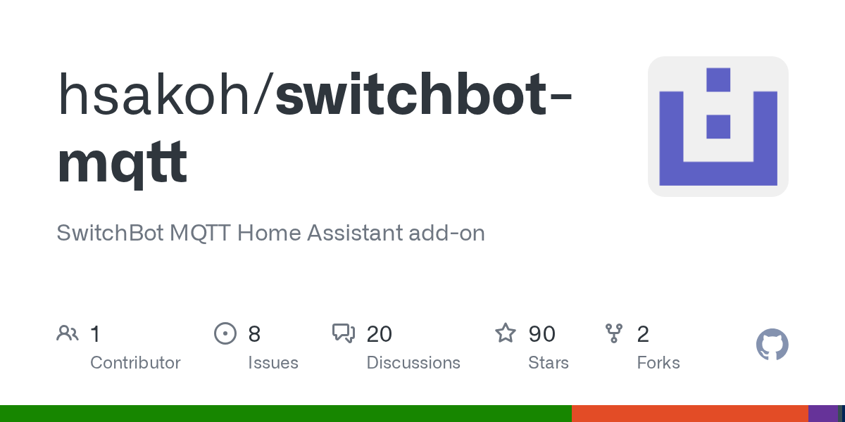

Have you tried this addon ? Its the only way I found to get all the data from my K10+
I also tried the new Switchbot bluetooth integration but it is missing a lot of the status info.
It needs a vacuum template to work properly though:

Thanks for responding - I was aware of that approach however as I run HomeAssistant container and don’t currently have a broker in my stack it feels like it would be a reasonable amount of work to switch across.

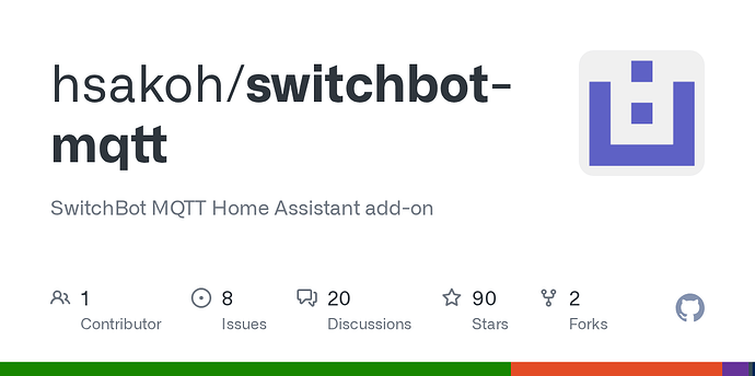

Not sure if you are using Docker, the addon github page has instructions for running it in Docker:
Thanks for the link, but really am not looking to add 2 containers (addon + mqtt) to my docker stack to resolve what seems to be a Switchbot issue as far as I can tell.
