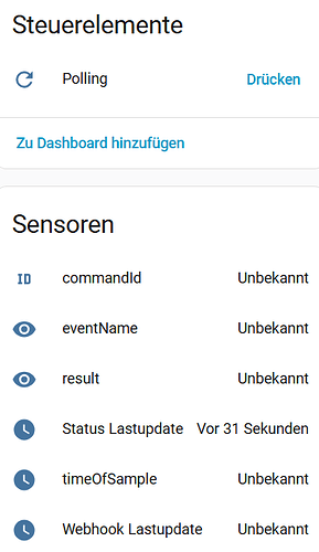

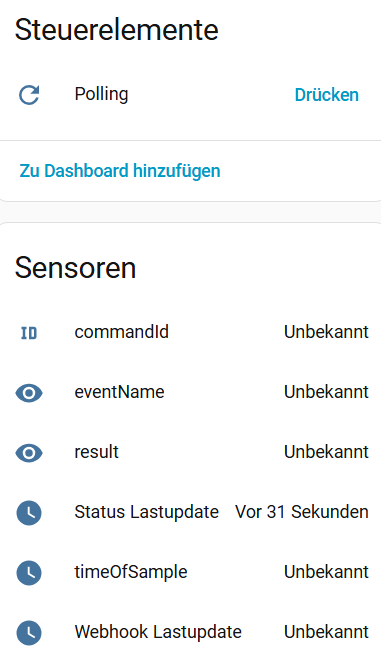

I also have the Keypad Touch integrated to HA with the Switchbot-MQTT Add-On.
I can create new codes too.
But I am missing the Sensors:
All sensors exept “Polling” are unknown.
Do you have more sensors?
BR Tommes
