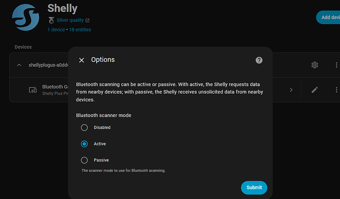

It let me do it:
That’s the scanner mode (whether it passively listens or actively asks devices to send out their data) but it’s still just one-way communication. You need active communication though. And yeah the terms sucks. Ha
