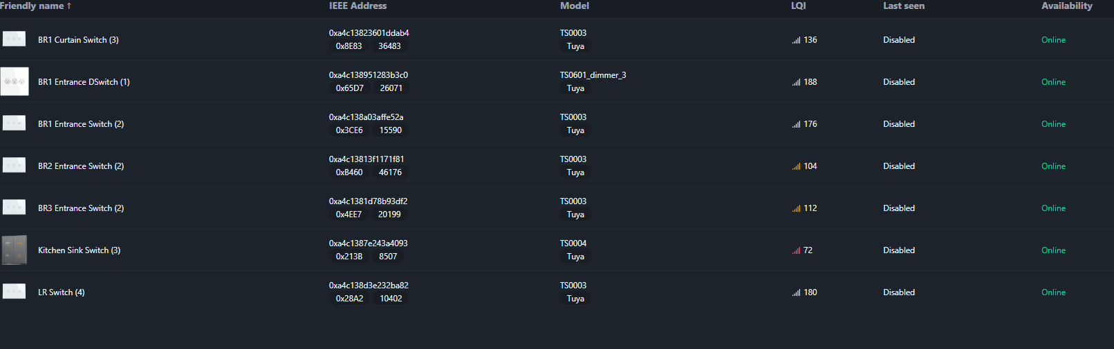

I have 23 Devices in the home (All MOES 3-gang dimmer switches), and periodically over time, the switches will lose connection and be off the device list in Z2M. Went from 23 devices to 8 in 2 days. Also, walking around the house, have seen some in pairing mode randomly.
The only ones that remain are the MOES switches, and only 1 dimmer switch left.
