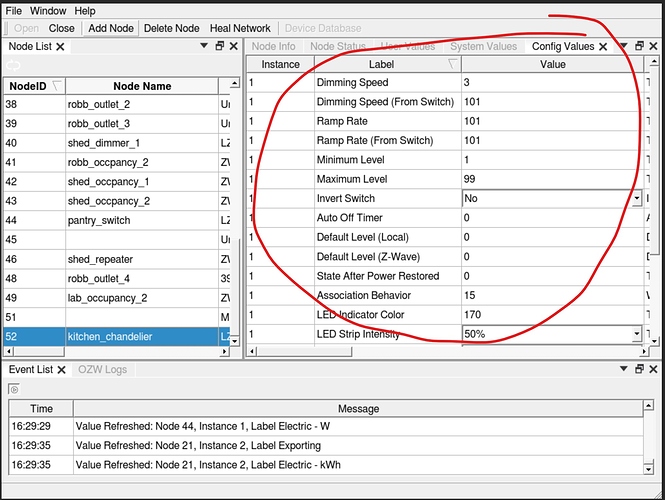

Question about configuring devices properties from ZwaveJS. I currently don’t see a way to edit the properties of a device. In OpenZwave beta we were able to adjust the properties and see details of the devices themselves (although slowly and through a buggy interface)… Is this functionality planned in the future with ZwaveJS?
It’s already there! See Ā«valueĀ» section, third from the top on the photo. But the position might differ depending of the device.
