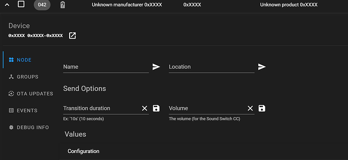

However, after a few weeks one device (window sensor) went to unknown manufacturer.
I have many of these devices (ring window contact Gen 2) and wonder how ZWAVE JS UI can loose this information.
Any idea?
And if so, do I need to exclude and re-include the device or what would be the smartes way?
thanks

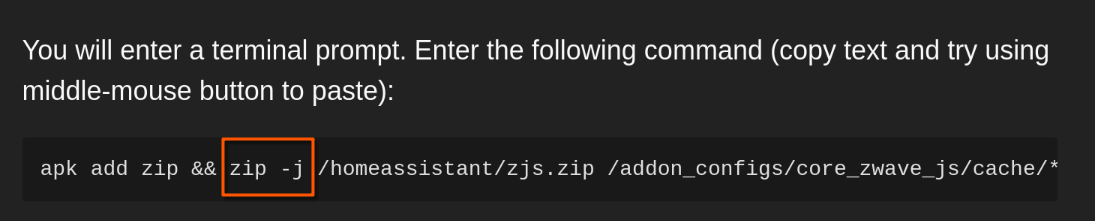

I got an error about -J command during the zip.
Chatgpt:
Your command is malformed. The -j flag you typed got interpreted as a command, not an option to zip.
Explanation
  • zip → program to create the archive
  • -j → ā€œjunk pathsā€ (don’t store folder structure, just the file names)
  • /homeassistant/zjs.zip → output file
  • /addon_configs/core_zwave_js/cache/*.jsonl → input files to include
Corrected command:
apk add zip && zip -j /homeassistant/zjs.zip /addon_configs/core_zwave_js/cache/*.jsonl
I have the advanced SSH & Web term. maybe thats why? Just posting incase this helps anyone else.
Your so-called ā€œcorrected commandā€ is the exact one used in the guide. Just copy and paste next time.
