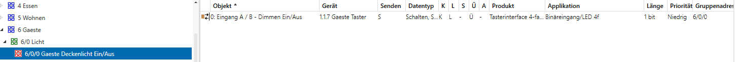

Hi Oliver,
I want to use a button on my universal interface (KNX) switch to communicate with an HA automation.
The button is not allocated with an actuator.
Do you have an idea how I can get that working?
Maybe you can provide some screenshots of the ETS configuration you used for that groupaddress?
you just need to create a new group address and assign the On/Off function from the switch to it.
In HA you can create a dummy switch:

Hey,
if you still have this topic open, send me a message. I have several of this dummy buttons, but that belongs not to this thread.
Hi, I was able to get it working thanks guys.
