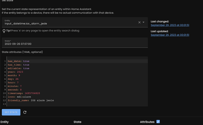

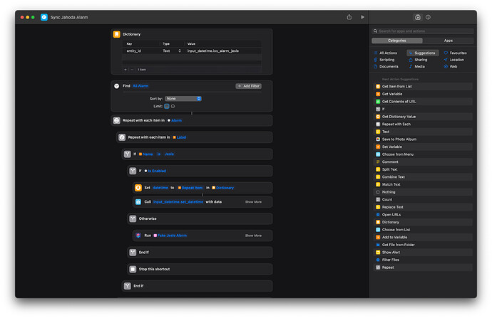

I have set the trigger shorcut in my phone to 00:01. If the alarm is disable, it sends a random date to the past. e.g. 01.01.20 00:00
