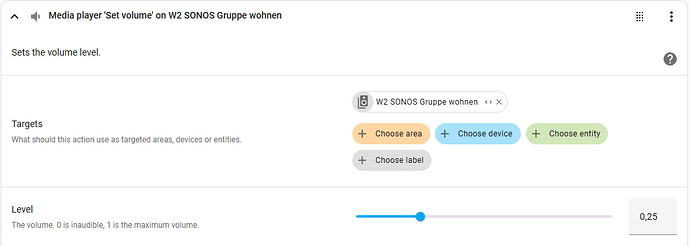

Maybe better solution, that works at least in automations.
Create a label e.g. “All SONOS speakers”. Give this label to every speaker an act from then on with the label.
