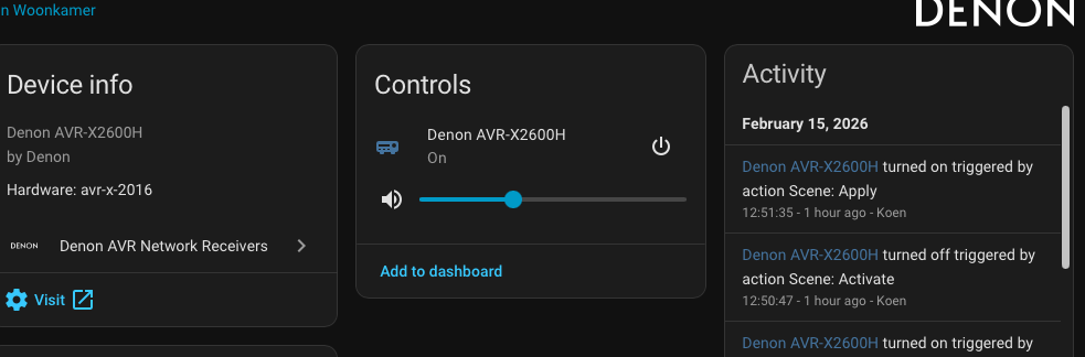

Hi WabsNL, I’m trying to achieve separate control for zone 1 and 2 of my Denon AVR-2600H as well. However, home assistant does not show any controls for zone 2 although the Denon app on my iPhone does give me this control.
Can you let me know how you got zone 2 in home assistant in the first place?
