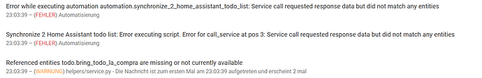

I get the following error message
This is how I use the blueprint:

Ok, the problem is, @HectorziN published a blueprint with hard coded todo list entities instead of retrieving them from the blueprint inputs:
  - variables:
      google_list: todo.google_keep_la_compra
      bring_list: todo.bring_todo_la_compra
      temp_list: todo.temp
This obviously won’t work for anybody, but him. :laughing:
TBH, I never published a blueprint and won’t start with this at 3am in the morning (*). Thus, please fix this blueprint manually, if you want to use it. You just have to replace the variables section with this:
- variables:
    google_list: !input google_list
    bring_list: !input bring_list
    temp_list: !input temp_list
And as @sh00t2kill already mentioned, you have to remove the first service call right below the variables section, as the bring.force_bring_sync service doesn’t exist in the official Bring! integration.
