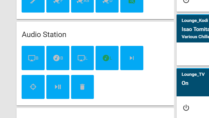

I’ve been engrossed in other things - but I have automated the audio station successfully; happy to share code. I’ve got multiple playlists playing to multiple remote speakers, triggered by voice commands from my android phone, and by our “return home”.
In regards to a web interface, I am going to assign various commands to a “custom UI tiles” interface.

What I did in the end was quite simple. I set up a bash script to accept a number of commands, called via the “shell command” component in Home Assistant. Rather than try to isolate a few functions, how about I just send you the whole lot?
shell_command:
  syno_audio_controls: 'bash /config/Scripts/SynoAudio/SynoAudio.sh {{ action }} {{ data }} {{ targetplayer }} {{ extra }} '
I only use this approach for playlists - playlists I have made beforehand. I mainly call the script’s actions from the web interface - a separate ‘View’ within Home Assistant ( see image below). I can choose the remote speaker (a drop-down which is dynamically populated from a query against Audio Station), I click an image that matches a playlist I want, and there are the standard control buttons you see as well. It also grabs the song info, allowing you to delete a song file in more confidence. The star button allows me to gradually build up a “5 star” smart playlist by adding a 5* rating to the currently playing song.

I will paste some snippets when I’m back home, but the gist of it is to make a script or switch that calls the shell_command and provides the variables.
Unless you have also implemented the Tiles UI, I’m not sure how you are best to present the switches and scripts within your UI?
UPDATE: some snippets. Hope these help.
The process relies on “Input Select” for Player and Protocol, which the scripts and switches use as variables. The REST Command in the post above will re-populate this list with all players that the Audio Station actually discovers.
