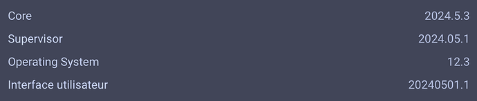

the problem comes back after upgrading HA to last version today
