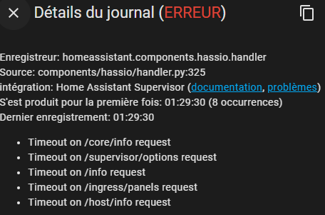

2025-02-18 15:17:05.848 ERROR (MainThread) [supervisor.homeassistant.api] Timeout on call http://172.30.32.1:8123/api/core/state.
2025-02-18 15:17:32.874 ERROR (MainThread) [supervisor.homeassistant.api] Timeout on call http://172.30.32.1:8123/api/core/state.
A lot of disconnects.
hi all, still having my HA unstable !
Each time i restart HA after upgrades, HA is getting wrong.
this is a new issue
no home assistant core response assuming a fatal startup error
Thanks for your help.
