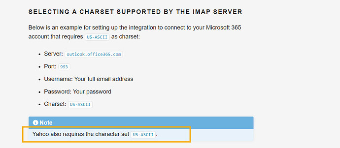

Hi. The imap integration only work for gmail accounts? I have a yahoo account I want to use, but I cannot get pass the initial setup.
I’ve never used a yahoo acct, but AFAIK it should work.
Does it work with the default search criteria i.e. UnSeen UnDeleted?
If the defaults don’t work, try spelling the folder name in all caps… IIRC some IMAP servers required that.
You may also need to use an app password instead of your normal user password.
no. nothing I have tried works. low caps, proper caps, default settings. the error message is random. It tells me that my user and password is invalid.
I had it working initial using the imap_email_content, but it has stopped working for quite some time now.

Yay!! I figured it and it was stated in the docs.
Charset: US-ASCII
