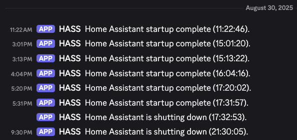

Running HA 2025.8.3 bare metal on a dedicated NUC. It’s been stable and reliable until mid-morning today when my wife noticed her media on a smart speaker kept getting reset. I pulled up the HA companion app on my phone and found it couldn’t connect; the system would restart itself sporadically. I have HA log some events like startups & shutdowns to a private Discord server. Shutdowns aren’t getting listed because the system is crashing:
