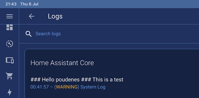

service: system_log.write
level: warning
message: "### Hello poudenes ### This is a test"

Thanks this worked. I had all my levels on error
