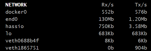

Glances is showing network thouroughput.

Ah ha! So here’s what happened. I was running HAOS v11 beta and there was a change with the network naming on ARM devices which I didn’t catch onto until v11 was released today.
If you have an ARM devices (eg Home Assistant Blue, odroid etc) you have to change your system monitor configuration and also the resulting system monitor network sensor entity_id’s in your configuration.
platform: systemmonitor
resources:
  - type: network_in
    arg: eth0
  - type: network_out
    arg: eth0
  - type: throughput_network_in
    arg: eth0
  - type: throughput_network_out
    arg: eth0
Becomes
resources:
  - type: network_in
    arg: end0
  - type: network_out
    arg: end0
    arg: end0
    arg: end0
Your entity_id’s much be changed.
sensor.network_in_eth0 is renamed to sensor.network_in_end0
etc. etc.
  • :warning: Breaking Change: On Arm based boards network names are enumerated based on device tree. This means that the first Ethernet devices will no longer be named eth0 but end0. The network configuration is automatically applied to the new network interface.
