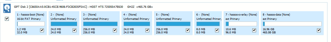

This is what macrium reflect sees…
But the first one is the boot partition and I was thinking if this one is ok then HA should attempt to boot and give out some error if the problem is with the other partitions, no?

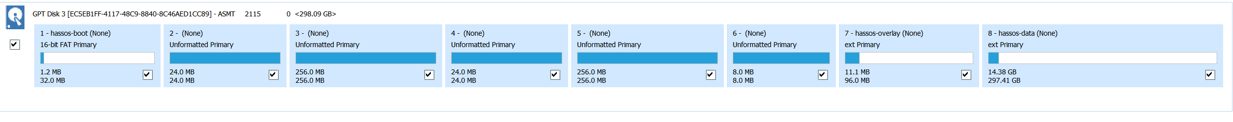

btw, here is how another HA disk looks in macrium reflect… all these partitions show unformated but the drive is bootable…
