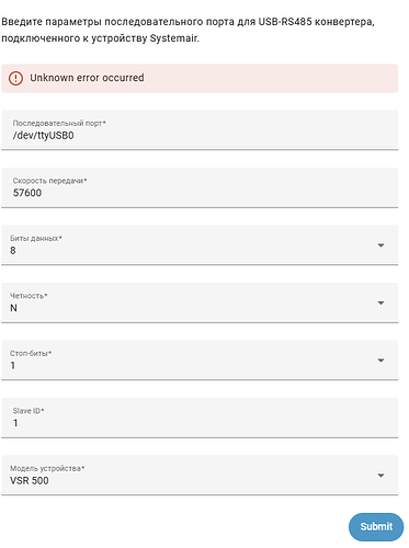

ValueError: Not a valid byte size: ‘8’
Please, create issue if you can at github - i’ll check when my usb-modbus converter reached me. This implementation is fully guessed and guy who requested this support disappeared. Ty in advance.
Edit: Ah, got it. Incorrect types, will be fixed at next release soon. Ty for test.

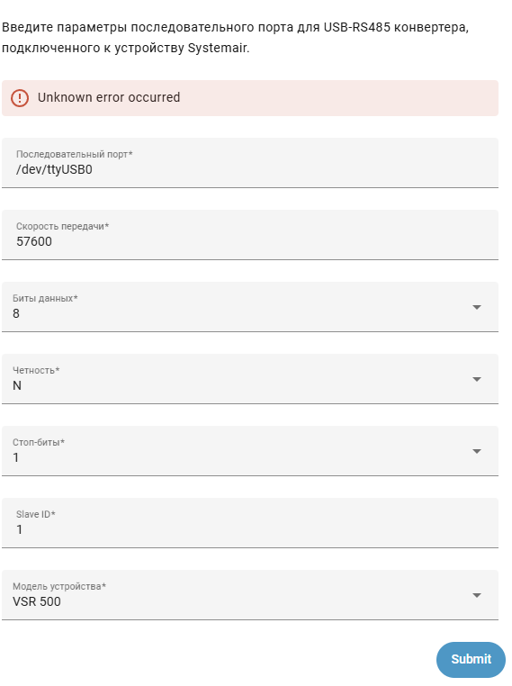

bought waveshare RS485 serial USB [CH343G Waveshare 22456]
But I can't seem to get any signal, readings or so, like nothing works, USB gets loaded and seen on dmesg.
I tried changing all the settings, baud rates, polarities of A+/B- different cables you name it :smiley: what am I missing? Maybe you can advise something how to make this work?
