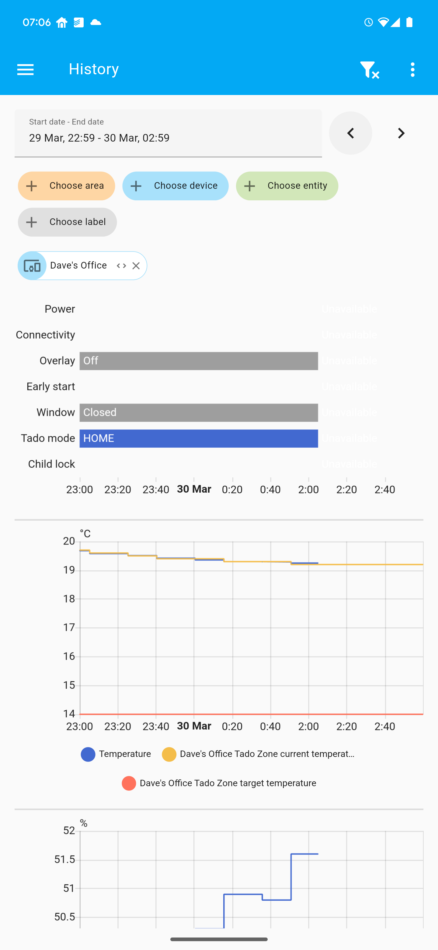

Same issue here, I can see in my logging, the Tado integration stopped working at exactly 2am here. Hope there will be a fix soon

Ah 2am, very telling, British Summer Time
