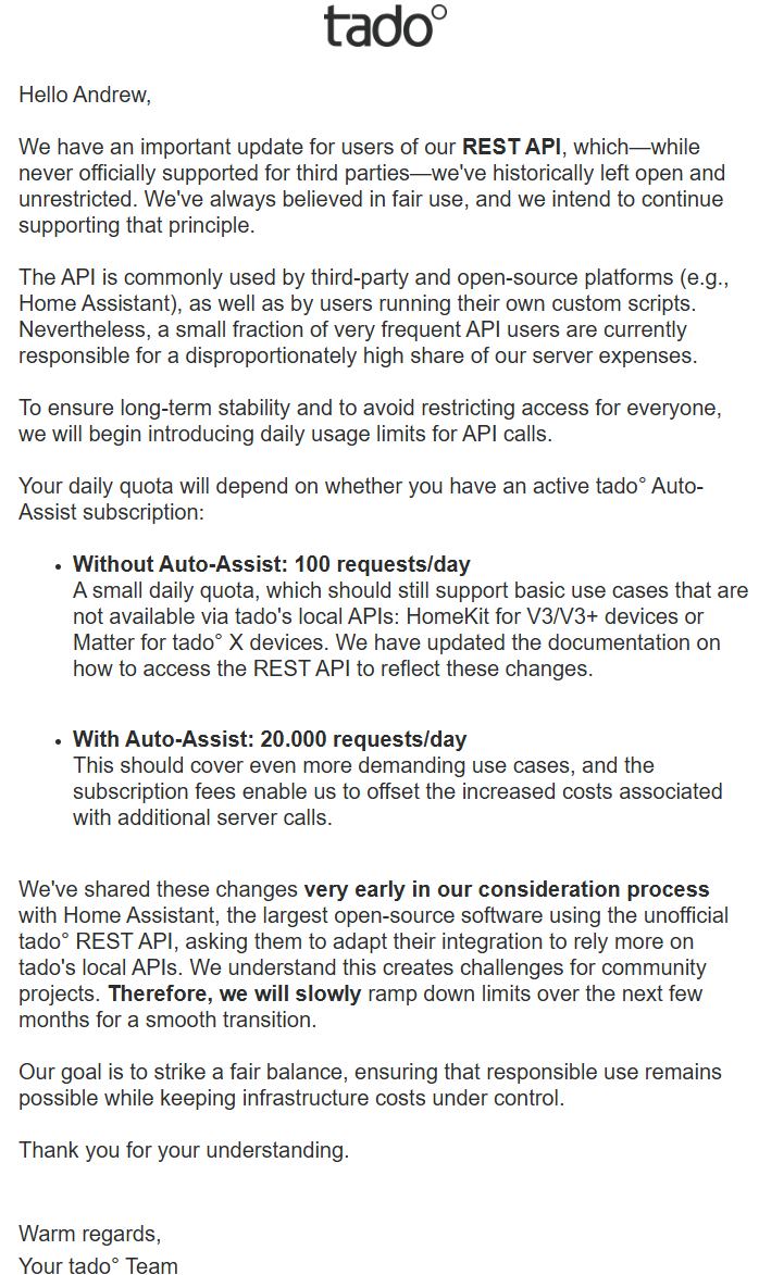

@EDouna will this latest announcement affect us?
Action Type Frequency Estimated Daily Calls
Polling (every 5 min) 12× per hour 288 calls/day
Automation/Commands Variable Adds on top
Total Usage Base + actions > 288 calls/day
Looks like will be forced to pay for API use under the banner of ‘Auto-Assist’ even though I am sure most of our instances take over the Auto-Assist functions.
AUD $53.99 / year or AUD 6.99 / month to ensure we can use the API to control the heat in our homes. A fair price I suppose for the server use.
For that price it would be nice if they supported us a bit better, especially since we have already shelled out for their devices.
Looks like they have also discontinued their community forum as well.
For me I think this is the nudge I need to move to LinknLink eRemote and eTHS, for full local control.
Yes, it will affect Tado in HA. He’s already working an a PR to mitigate impact.

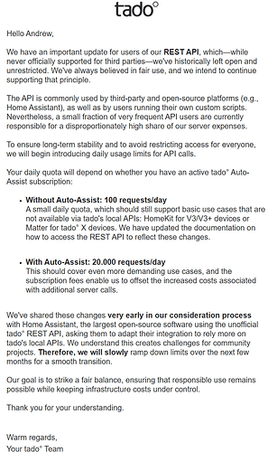

I too, just got the email about rate limiting. Everything except my hot water control is exposed through homekit, but what happens when you do that, but you still have schedules running on the tado server ? I assume they would just overtake the setting applied locally via homekit ?

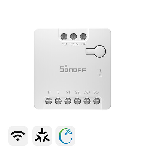

Then I realised I could do it all with a few Sonoff Mini-D modules:-
These can act as ‘dry’ switches which is whats typically used in thermostat switches (they only complete a circuit, they don’t contribute any mains power like a normal ‘wet’ switch does.
The downside is that this solution does not support opentherm modulation. I my boiler supports it, but my existing tado extension kit doesn’t (apparently the UK versions don’t, but the EU stuff does…)
So missing opentherm isn’t a biggie for me.
I’m going to start as a trial and disconnect the hot water control from the tado extension kit and route it through the mini-d instead. That might be enough, as the rest I can control through homekit; or I might end up replacing the rest as well.

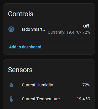

For example, the tado integration shows this for a thermostat control:-
And the homekit version shows this:-
If you care about those other sensors, then thats an issue.

Given that Tado are also going to be moving to seriously restricting their API usage, unless you pay a subscription fee, I decided to de-tado my house.

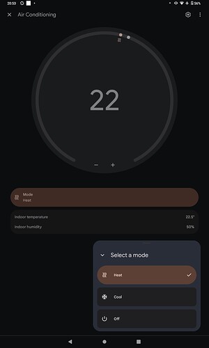

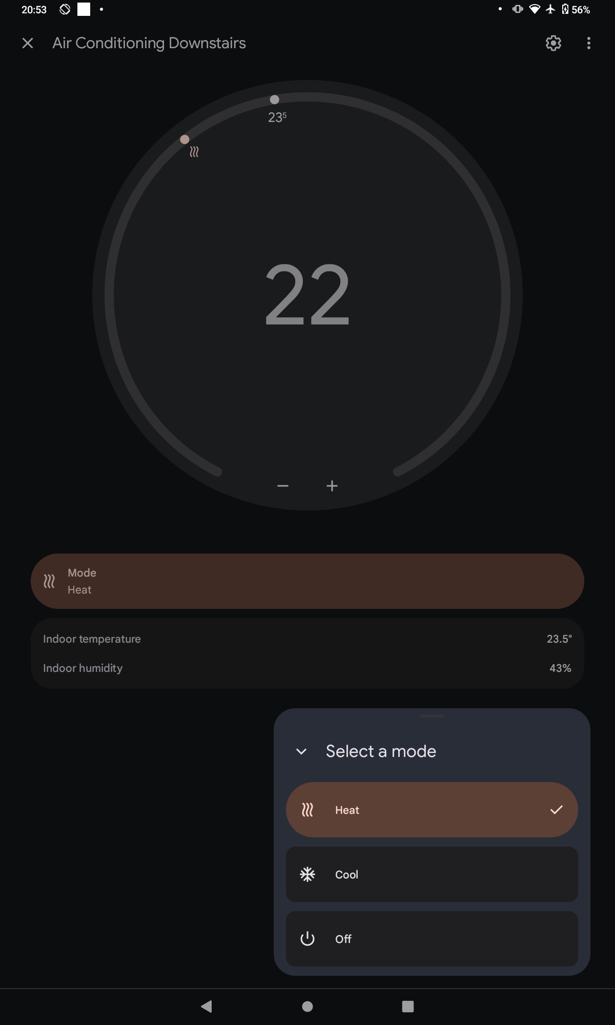

Would it be possible to stop using the tado integration and use the Google Home integration instead? https://github.com/leikoilja/ha-google-home
tado devices can be added to Google Home relatively easily and could then be accessed via the Google API…
That is not a bad idea if possible.
AC V3+ lacks dry mode in google.
