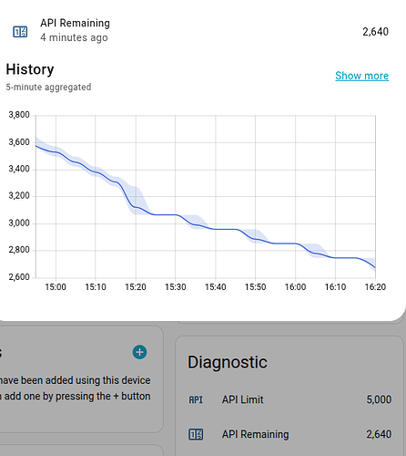

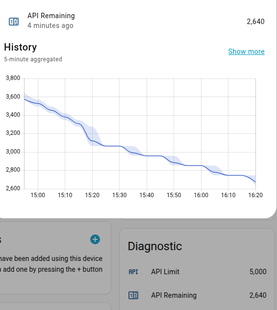

I’m hitting this problem also with the API limitations, unfortunately my home assistant instance is not local to where the Tado installation is so I can’t use the tado_hijack with homekit.
What I have done though is cloned the erwindouna:tado-add-rate-limit-info repo and branch, i’ve now got a view of the API queries and remaining like this:
What I’ve also done is reduced the polling interval (My use case is to retrieve temperatures from each TRV to map temperatures in a large building with many rooms) like this:
SCAN_INTERVAL = timedelta(minutes=15)
in tado/init.py and tado/coordinator.py
What I’m now looking at is reducing the number of api queries that I don’t require. My thinking is in function _async_update_data to remove:
                self._tado.get_me(),
                self._tado.get_zones(),
Or perhaps move those into a longer polling interval as that data in my case won’t change and it’s a wasted API call (weather, geofence, etc not needed for me).
Just after opinions on others if this is a reasonable approach to take for now to reduce API calls until there are other options (The proxy may be an option but I want to explore that further first).
If it’s useful I can always put my changes into a repo if you want to use the same tweaks and just use it as a custom_integration override.
