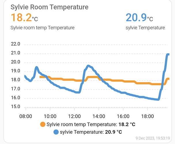

I’ve installed a few zigbee thermometers in key rooms and have significant variation from the TRV sensed temps.
I’m going to code something to replace the logic in the tado system and get HA to take it over using this more accurate data.
