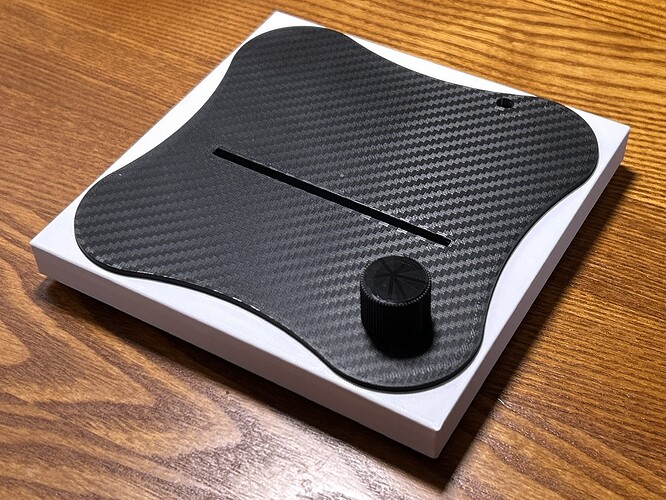

TagTuner music player for NFC tags
I’ve refined my old project with a brand new device style.
This is TagTuner which allows me to play music with NFC cards. There is only one automation and card holds stream url in Music Assistant format or direct http link to source if used with Sonos.
For more details please see github pages

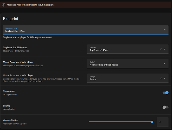

Thanks! I finally got around to trying to use it. I was previously using your pre-shuffle blueprint. Now that I’ve updated, I get an error stating I’m “Missing input massplayer”. I’m using Sonos and Spotify so I shouldn’t have to enter the Music Assistant player right?
just set the same player there. There is no good way of doing MAss and http/Sonos players in this blueprint.

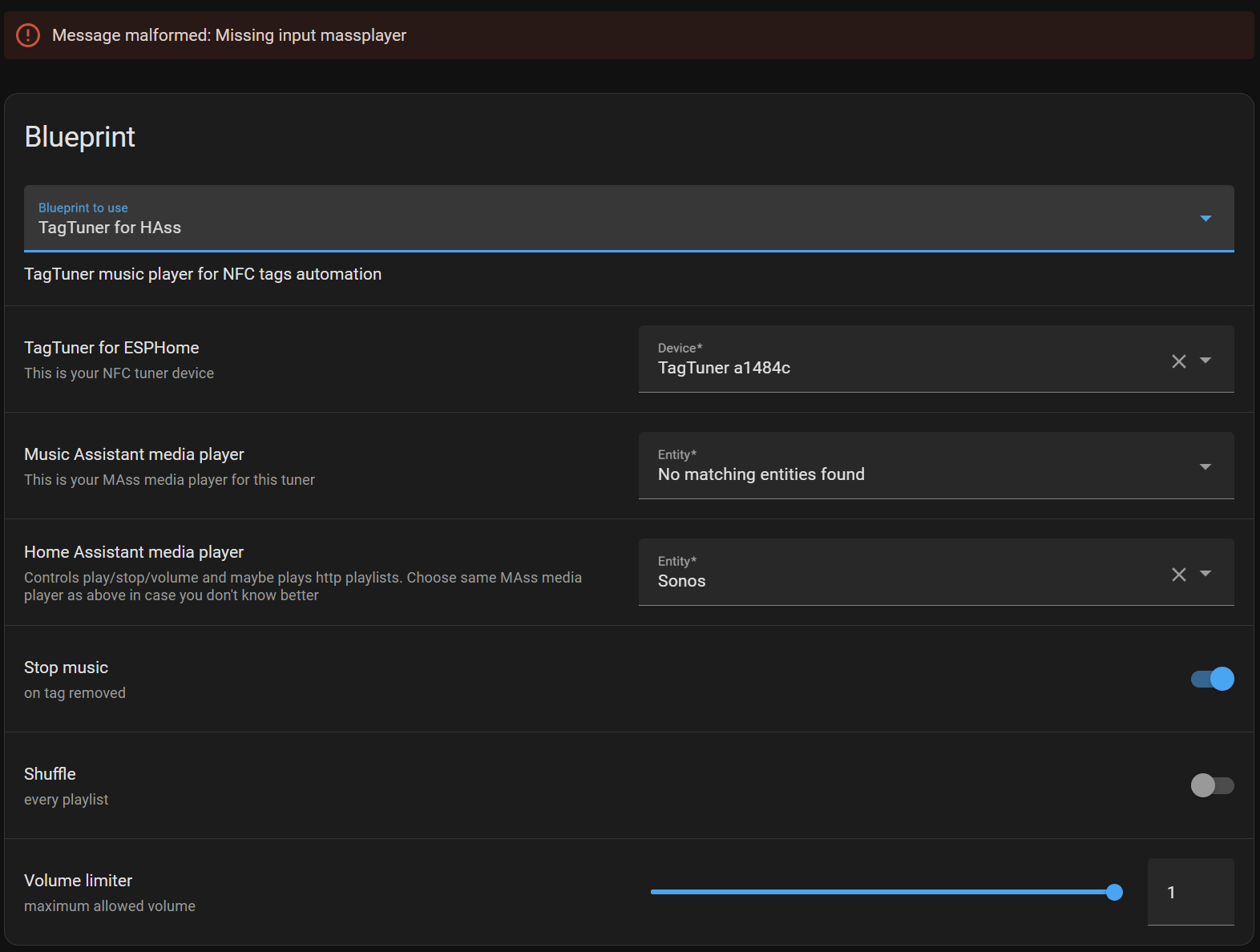

I’m also getting a similar issue-
It doesn’t look like it’s connected correctly and I’m not sure what is wrong. I’ve just done a fresh install of HAOS, automatically added my Sonos system to it, then installed music assistant server (with apple music) and home assistant plugin.
ok, you are guys right. I’m sorry. This happened with the new Music Assistant core integration.
I’ve just pushed January blueprint update that was already cookin so refresh or reimport the blueprint and let me know how’s that working.
Works perfectly now, thanks for the quick support. My family’s gonna love the flexibility since it’s super hard to hookup a CD player to my sonos kit.

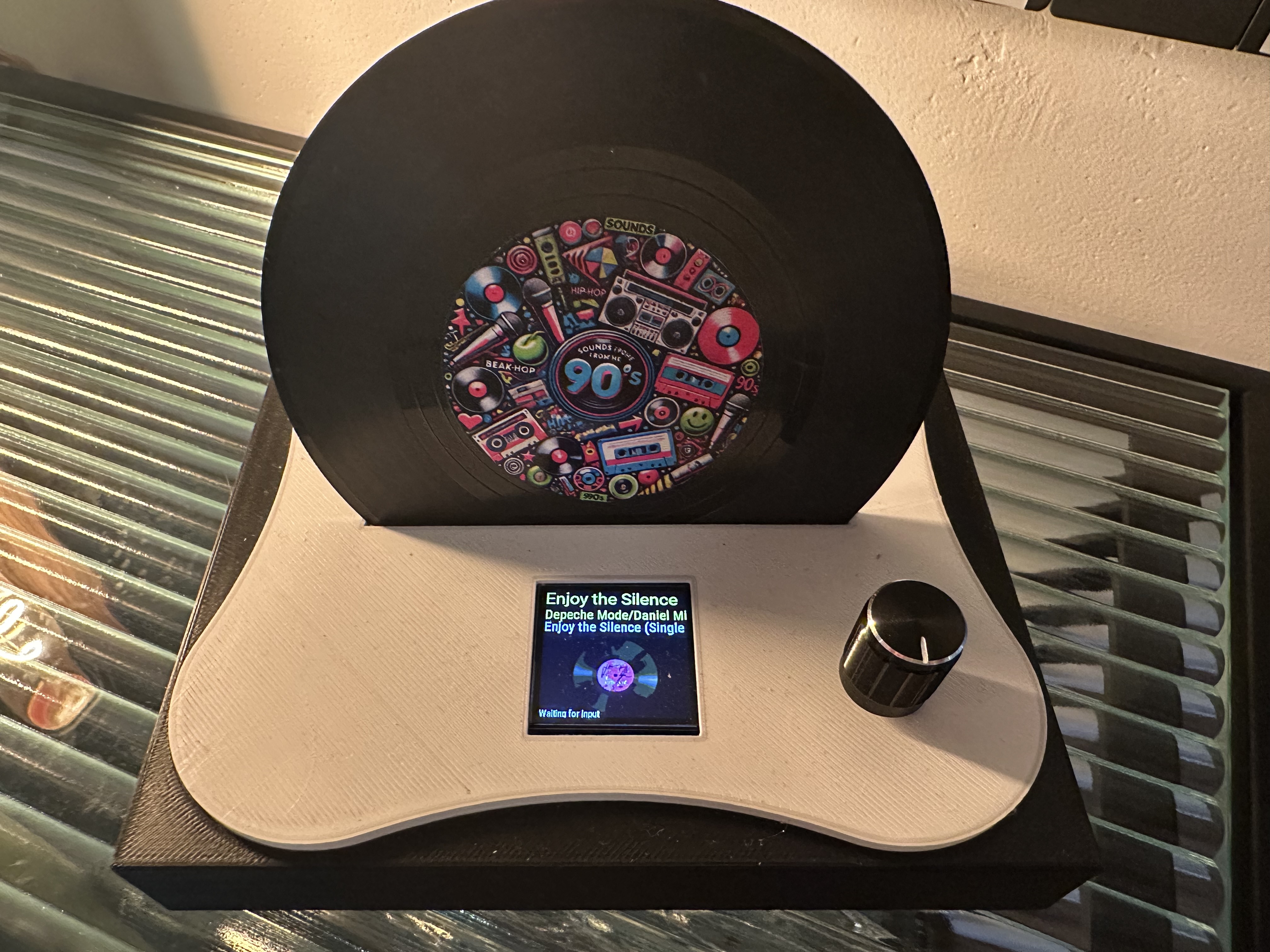

Hi Luka, great work you did on this project i really like it. I made some changes and added a small display to show the status and song title/artist/album info.
I updated the esphome config and created a separate blueprint for sending the currently playing media info to the tagtuner esphome. Can you add this to the project and merge the blueprint with the current one ?
Here is how it looks like:
Let me know if you want to merge it then i will provide you the esphome config / blueprint and updated STL cover for the display.
/Cheers
