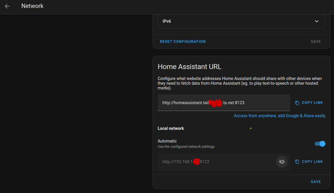

I’ve recently installed Tailscale on my Home Assistant server and on my mobile phone where I use the HA companion app. It worked at first but I needed to connect with Tailscale eventough I was on our home wifi.

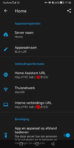

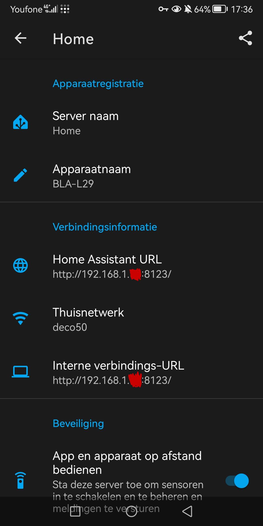

I tried to fix it by using several options with external settings in the HA companion app but nothing changed the situation.
TLDR: How can I configure HA companion app to use my internal IP when I’m on home wifi and the external ip to use the Tailscale magical dns when I activate that?

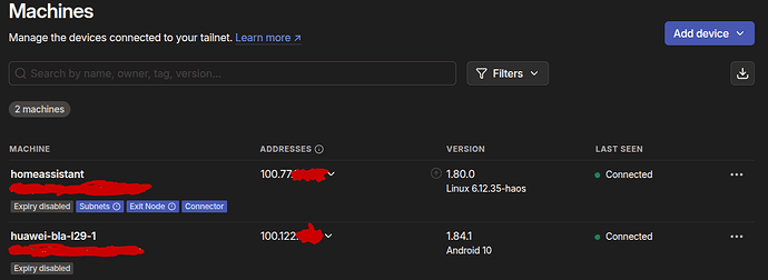

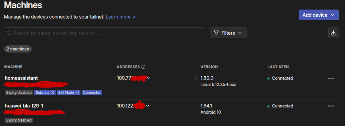

Use the addresses that start with 100.xxx.xxx.xxx:8123 from tailscale admin page as the home assistant url. Use the 192.xxx.xxx.xxx:8123 for the internal url.
Thanks this was it!
