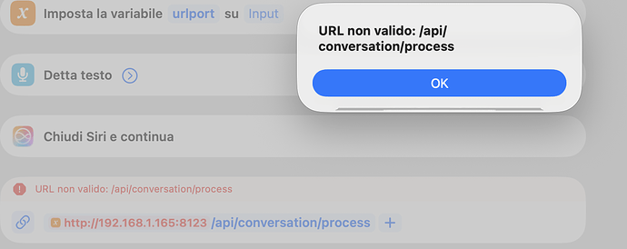

@PinkWaters i have this issue:
why? could it be the space between “…8123” and “/api…”?
