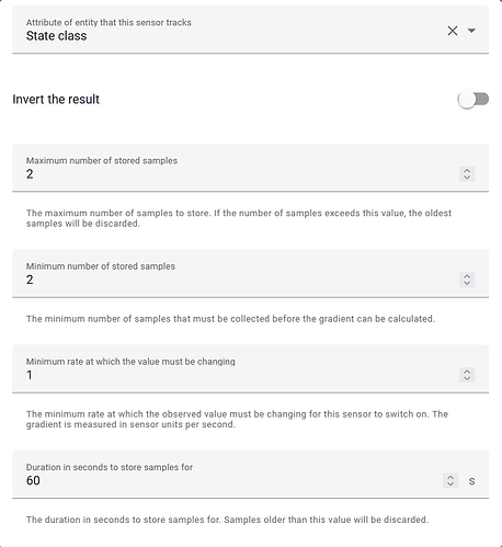

So I’ve created this helper now that is supposed to switch to “Charging” when my cell phone’s battery percentage increments by 1% or more.
New trend helper:
I edited the helper to set the following:
The value is definitely going up:
But the helper state stays Unknown:
Any obvious wrongs I’m doing here?
Looks like you’re tracking the state class (which obviously isn’t changing nor is it numeric) versus just the state of the entity itself. Never used the trend sensor, but I’m guessing you can just leave the attribute field blank to have it use the actual state of the entity.
Thanks, I was not sure what is supposed to go in that field. I’ve cleared it, nothing selected in attribute, but now the cell_is_charging
state is “Unknown”.
It also looks like you’re only storing samples for 60 seconds, so unless your battery is changing really fast there won’t be enough samples for it to calculate a trend.
Thanks again, it’s charged 10% but it is still in a off state. I think there is more than just gui work here. Trend - Home Assistant I’ll read up and see if there’s a youtube about it.
Reading up on the docs is always wise. It also looks like you’re using a minimum rate of 1, which per the definition right beneath it means unless it’s charging 1%/sec, it’s always going to be off.
yea that part does not make sense to me. Very few things move that fast. My battery % (and tank level etc) is measured in 1% increments (whole numbers). I assumed I misunderstood it.
Yeah, I agree the timeframe seem unintuitive for most things, but I assume the intent is to use decimals. Never used that integration though, just reading/interpreting the docs.
