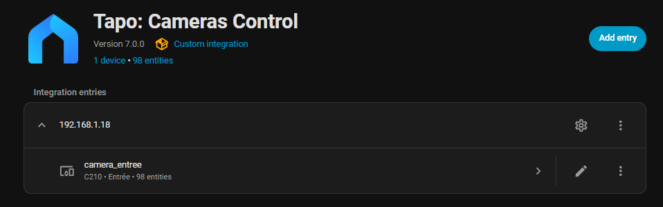

My Solution on a Tapo C520WS: Delete the camera in Tapo Control, give her in the Tapo App a new IP(!) (Generell static IP’s are a clever idea for the Tapo Control i discovered), and reconnect it. No chance on the same IP, there is something in the memory/storage in Tapo control. After reconnecting the Camera with a new IP, everything works (need to adjust the Preset-Automation, but thats alll)
