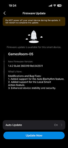

Hey,
Looks I have similar issue... Got 6x L630, 4x of them on old firmware, 2x updated to 1.4.2 and two of them stopped working(3rd in the queue to update, luckily I was able to turn it off).
This is the changelog I was able to pull out...
Official answer :
Home Assistant is not an officially supported third‑party platform. New firmware releases sometimes include security fixes and updates, and if third‑party platforms don’t integrate these changes, connection issues can occur , this is a common situation with unofficial integrations.
There is a Third-Party Compatibility feature in the Tapo app. You can try enabling it before linking with Home Assistant to see if that helps. However, please note that enabling this option may introduce security risks and does not guarantee compatibility with unofficial third‑party platforms.
