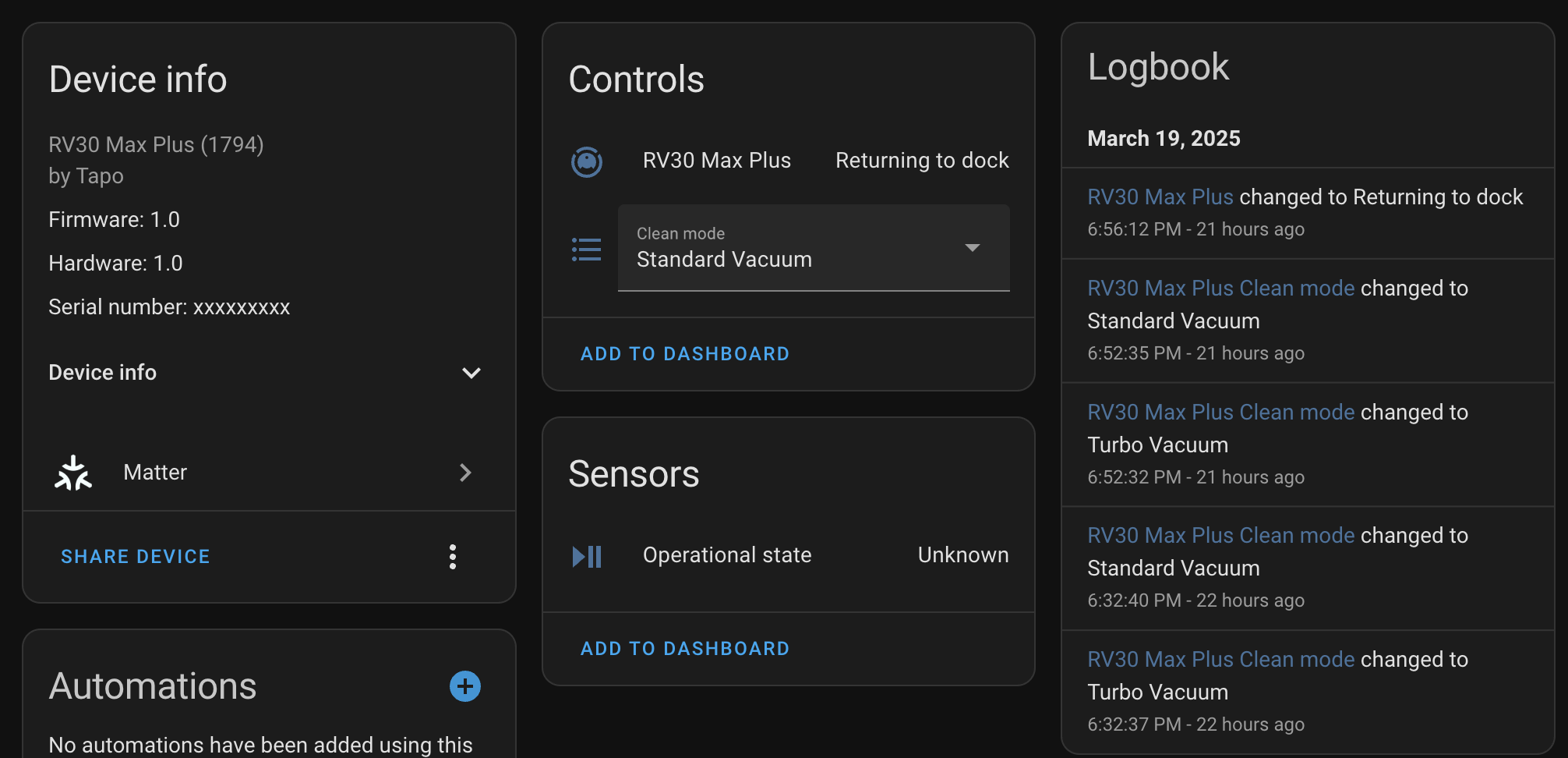

Hello! My partner recently purchased one of these robovacs, and they excitedly told me about a new firmware update supporting Matter. I jumped off the couch in disbelief and found that you can indeed now add the RV30 Max Plus to Home Assistant using the Matter Setup Code in the Tapo app, and using the Home Assistant Companion app. It doesn’t seem to fully work yet but it’s a good step forward. I have buttons to pause, start and send back to dock, and I can change the mop settings. So far I have seen it report “Error” status and “Returning to dock” status, so it’s communication something, at least! I could not get it to connect using the TP Link / Tapo integration no matter what I tried.
Link to mention of Matter support:
Edit: You can also change the mop/vacuum mode/speed, and the device responds with a confirmation tone, but I can’t get it to start or pause or go back to the dock.

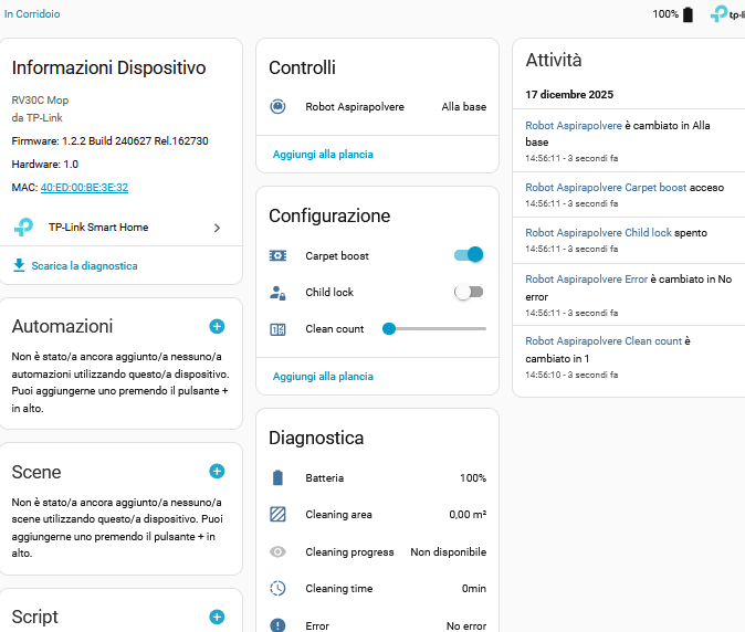

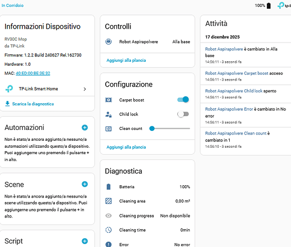

Hi, I can connect my RV30C without issues, i’m in Italy. Maybe is a different firmware:
edit: In TAPO app there is a “home assistant” related option → account section → third‑party services → third‑party compatibility-> set to ON (I’m traslating from italian app so text may differ a bit)

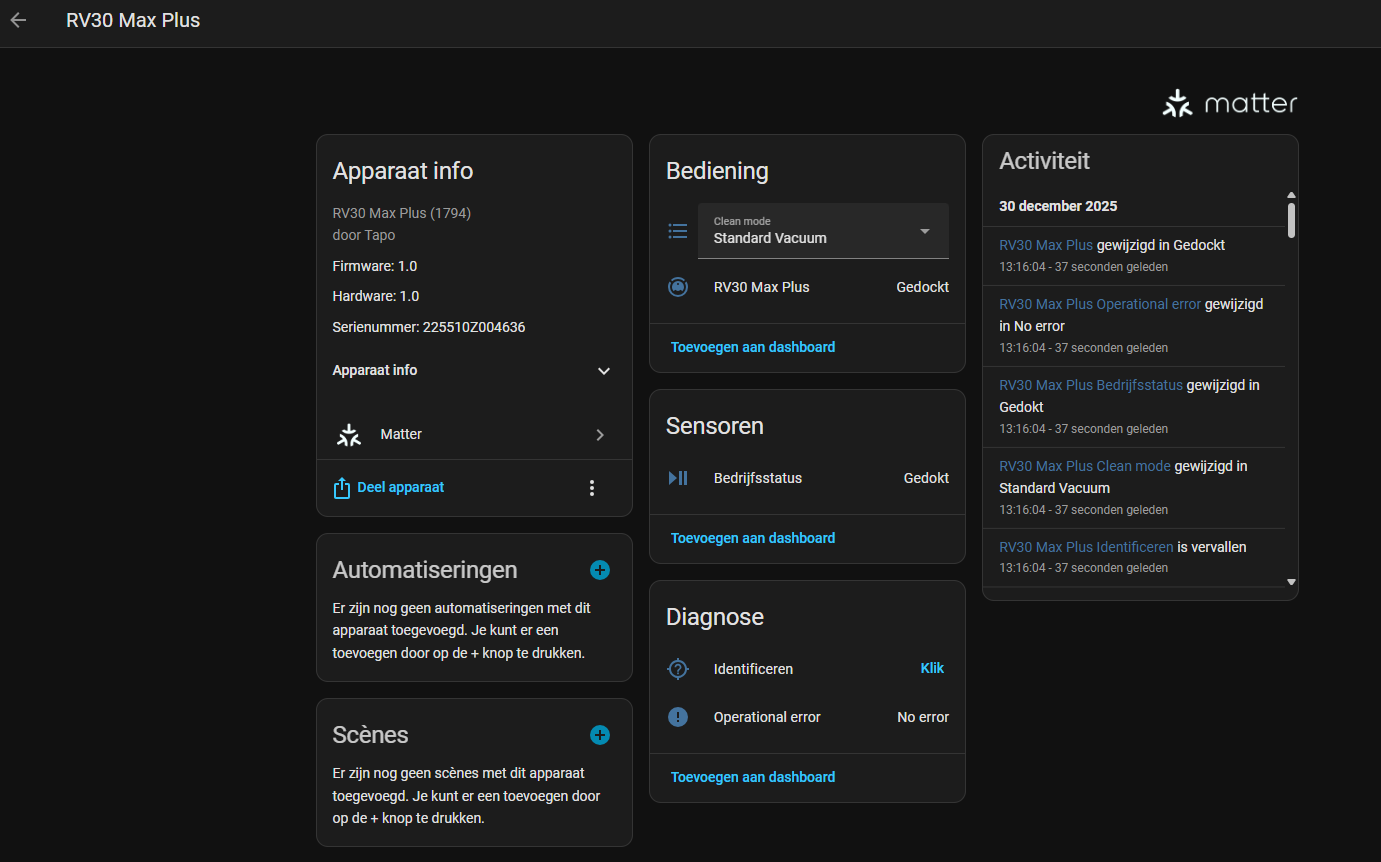

I was able to add the TAPO RV30 Max Plus to homeassistant through a matter server. I installed the Python Matter Server.
When the server is up and running you need to add the matter device through the mobile app. Write down the connection code (just a tip, or have the QR code available).
Still working out the possibilitys, but it is a start.
