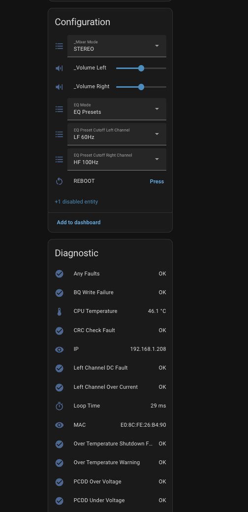

0. TAS5825 support on the same level as we had it of good old 5805M. Few extra faults, GPIO conifg to display warn/error state via LED is a bonus,

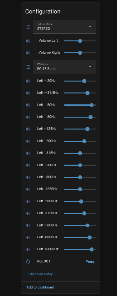

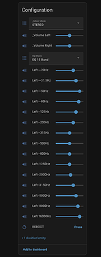

  1. Default EQ mode for both TAS models is 15-band Eq, same as it was before,

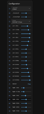

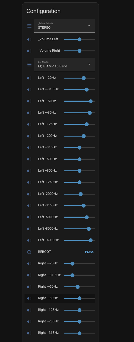

  2. Bi-amp mode is 15-band EQ per channel - you can apply different settings for asymmetrical setups,
  3. EQ-profiles - these are hand-crafted profiles for LF and HF drivers with 4-th order filters, cutoff frequency can be set in 60-150Hz range, so it is mostly for subwoofer/satellite use.,
  4. In every mode you get ability to adjust gain per channel - balance of some sort,
  5. Modulation mode is a user option now. 1SPW mode allows to make it more efficient with a slight THD degradation.
Other settings, like analog gain, mixer mode, volume dynamic range, are available with no change
Cherry on the top: @hnykda added silent boot sound - serves the DSP initialisation purpose, but startup sound, as useful as it can be, is optional now
All configs for Sonocotta Esparagus and ESP32-Audio boards are updated already, to feel free to try it out.
Some screenshots for each EQ mode are below
